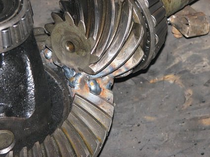

06-02-2011, 10:37 AM | #9 |
Join Date: Mar 2009 Location: Portlandia, Oregano
Posts: 2,569
(View Stats)
Rep Power: 0 Thanks: 2,295
Groans: 196
| Not Ranked : 0 score
__________________ |
The Following User Says Thank You to triplejumper18 For This Useful Post: | breakfstincluded (07-03-2012) |
06-02-2011, 11:26 AM | #10 |
Join Date: Jul 2008 Location: Canada
Posts: 35
(View Stats)
Rep Power: 0 Thanks: 0
Thanked 16 Times in 4 Posts
(Thread Starter) | Not Ranked : 0 score Damn triplejumper18, what caused that to happen? |
06-02-2011, 12:15 PM | #11 |
Join Date: Jul 2008 Location: Tucson, AZ
Posts: 1,482
(View Stats)
Rep Power: 739 Thanks: 517
| Not Ranked : 0 score ......wow, you didnt get the joke. Tha picture is called internet joke. Front diff is open, rear diff is limited slip. Meaning as long as the tires on the rear are the same, it doesnt matter too much on the front tire tread depth. What fluid did you refill with?

This is very useful information, thank you very much, i will call the stealership with this info and see what they say. As for the oil, i don't remember the brand, some sort of synthetic LSD oil, the mechanic called Mazda to check whats required though. | |
