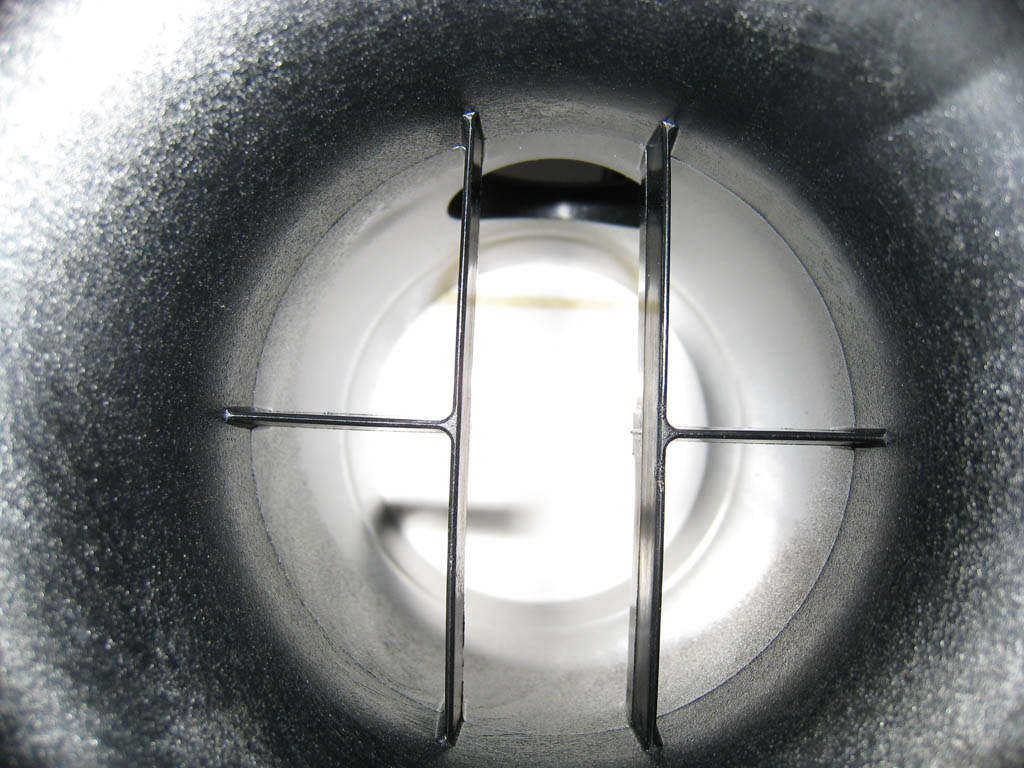

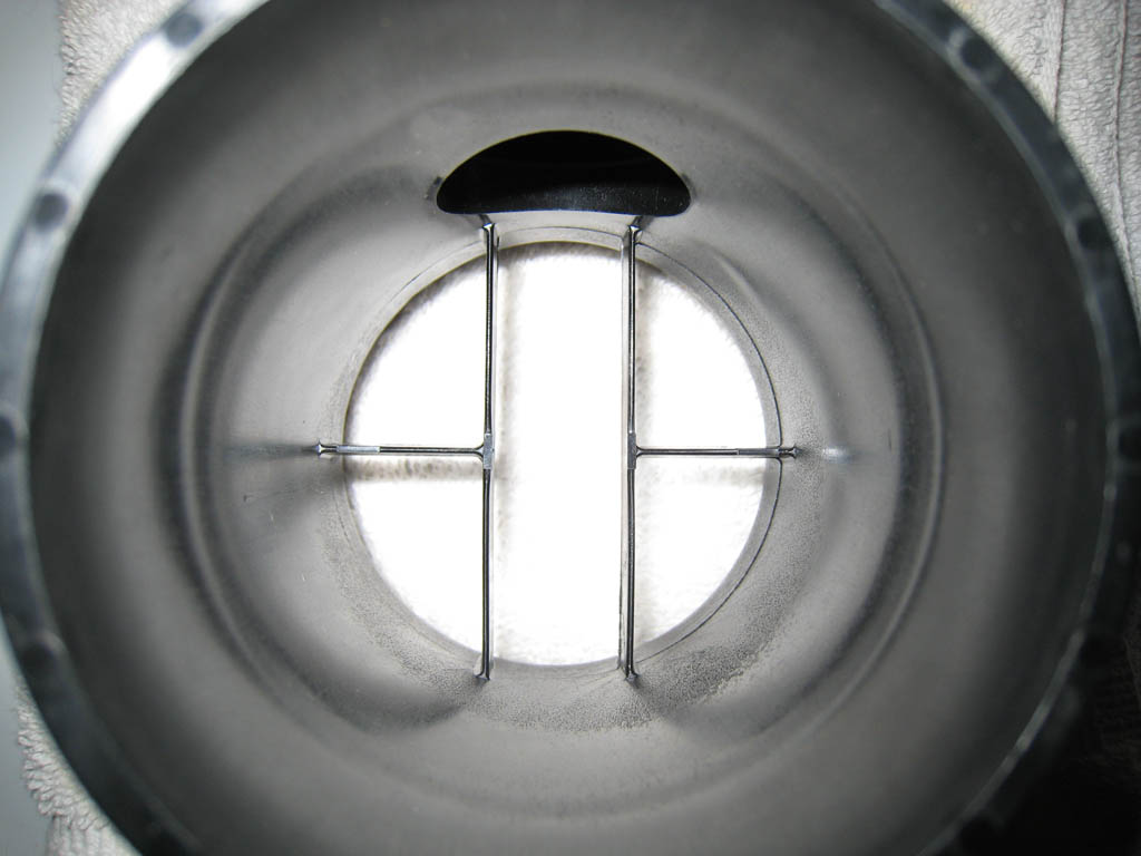

The second piece designed into Cobbs SF SRI, is the air straightener. Completely unique to many intakes on the market for the Mazdaspeed 3, only Cobb and CP-e utilize this technology for their intake systems. It's for obvious good reason, right? Of course. Air straighteners perform a very simple function. The design has long enough straighteners in the MS3 configuration, to stabilize the airflow before it goes across the MAF sensor. This promotes a more laminar airflow and essentially creates a much more stable environment for the MAF sensor to sample from. As pointed out earlier, other intakes on the market have proved less than ideal by causing lean conditions. This is contributed to the erratic airflow that enters the pipe, than continues to become more turbulent as it flows across the MAF sensor, causing lean conditions, erratic idling and MIL codes. It's known that even Mazdaspeed's own CAI was removed off the market, from owners suffering from these very symptoms.

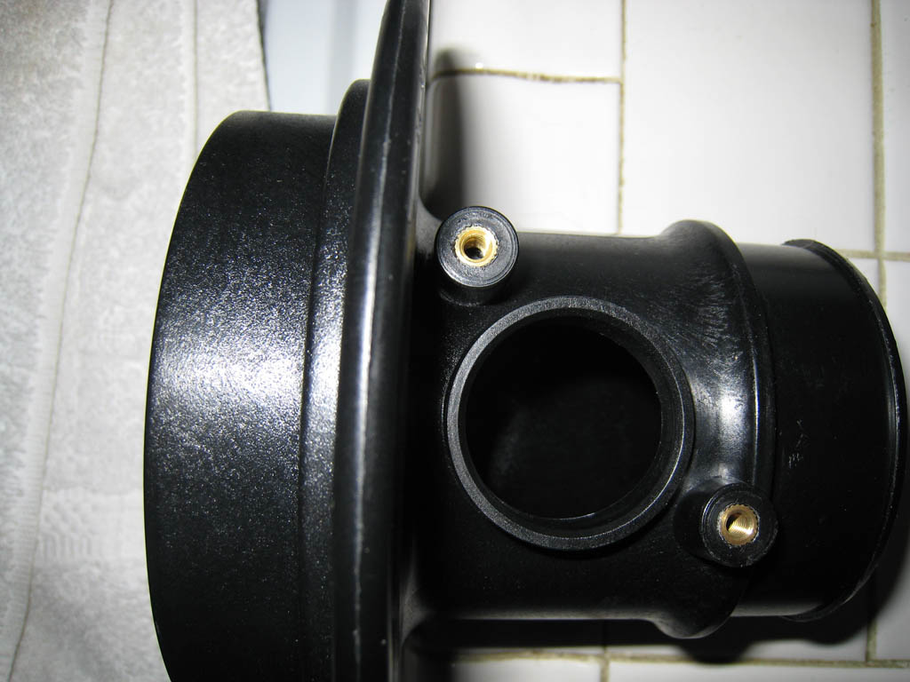

Now the fourth piece and probably one of the most crucial places in an intake... The MAF sensor housing itself. Data has shown that any fabricated intake system introduces inconsistency in performance due to the manufacturing techniques. The degree, angle, and location of the MAF sensor is critical. Even mounting the sensor at 90 degrees from stock will results in a different measurement. The stock MAF sensors are designed to work in a particular configuration and if the tooling used to position the MAF sensor is not consistent then the measurement from the MAF sensor will not be consistent. Every one of Cobb's intakes are made with the exact same tooling, no welding, no CNC machining, etc. This allows for a part to part variance that is much less than an intake that requires additional steps to fabricate. Cobb is able to hold very tight tolerances with this injection manufacturing process.
