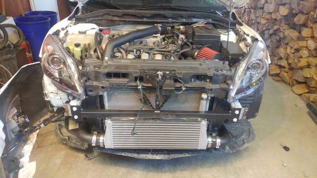

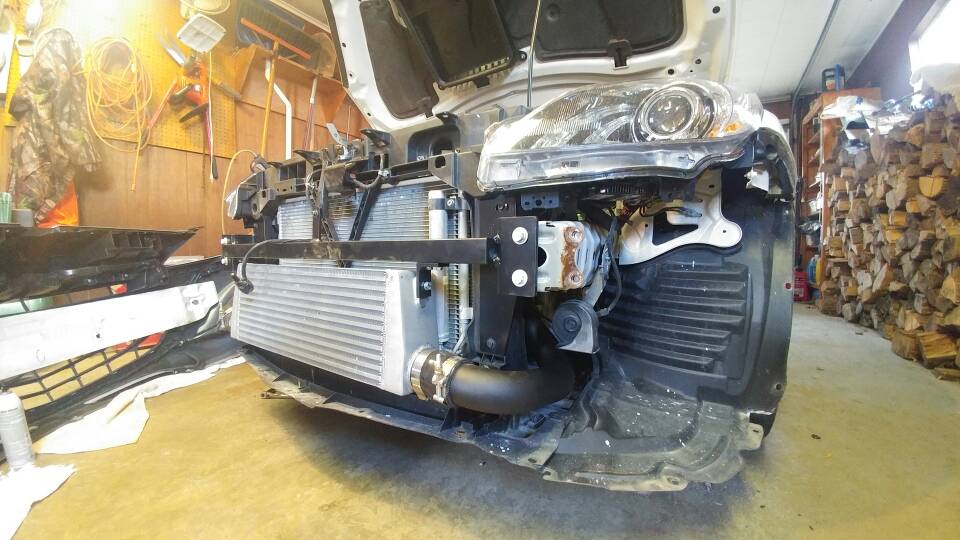

(Thread Starter) | Not Ranked : 0 score Update: I recently got the kit in and threw it on the next day. Fitment was great, went on very easily. The whole process took around 2.5 hours, the most time consuming was finding where the front bumper was hitting. Ended up being the foam on the stock grill piece. A small notch needs cut/melted on each side for the Treadstone crash bar to clear. I ended up cutting a spare grill I had and didn't use the foam at all but you get the idea.. Sent from my LG-H820 using tapatalkreplace |

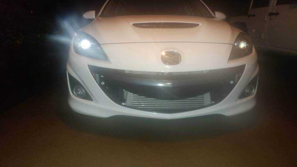

| @LowFlyin; do you have a front shot with the bumper on? Interested in how it looks with the grill like that.

Ill get a better one after work. Sent from my LG-H820 using tapatalkreplace | |

| Not Ranked : 0 score Just received this intercooler, going for a different pipe routing though. the bumper cut out of the "many chins" looks quite good!
