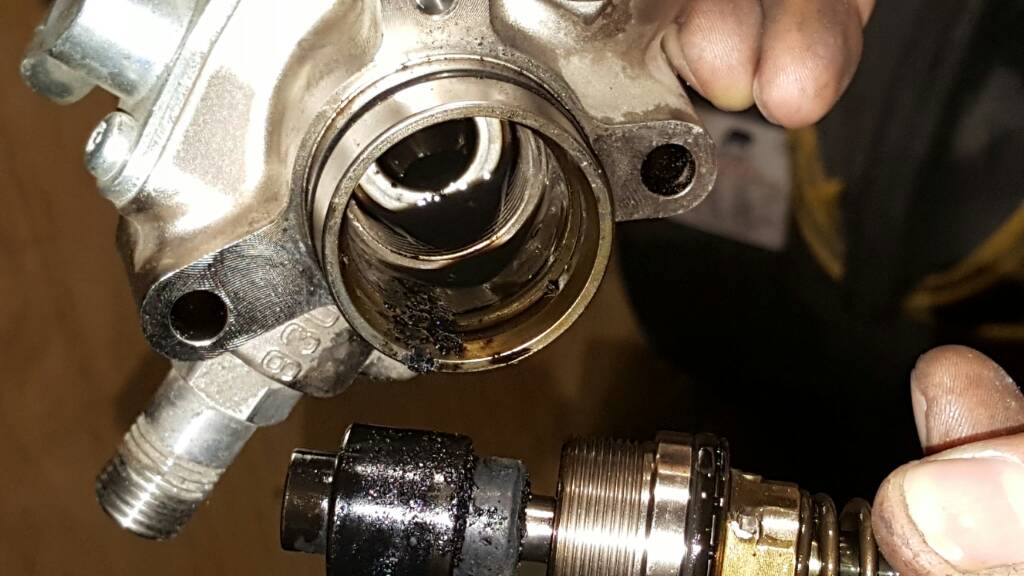

Here's a pic of my stock hpfp they showed me as they removed it to install.the new cobb
Sent from my LG-H901 using tapatalkreplace | ||

12-10-2016, 03:14 PM | #21 |

| Not Ranked : 0 score looks like the shop is none-to-kind with your car.

| Not Ranked : 0 score Nice spot! That should be fun.

(Thread Starter) | Not Ranked : 0 score In what way does this picture you quoted tell you they are "none to kind" with my car? Or are you just another troll with nothing to input Sent from my LG-H901 using tapatalkreplace Monkey see monkey do...the negativity here is awesome...you must love your life Sent from my LG-H901 using tapatalkreplace Last edited by deltapsik0; 12-11-2016 at 12:52 PM. Reason: MSF Database - Automerged Doublepost |

Get the shop to start listening to what people on here are saying. Or get it out of there, and get in contact with locals in your area who know what they are doing. You need to tell them to take better care of your shit, unless you don't give a fuck about it either.

| Not Ranked : 0 score Maybe you should pay attention to what he outlined in red in that picture before you throw a bitch fit, yea?

Not a bitch fit..just some forums people are super elitist and want to talk shit instead of help Sent from my LG-H901 using tapatalkreplace
Shoulda coulda woulda... Unfortunetly I don't have a time machine and as I stated before I couldn't find the normal forum. Yes I want to a shop that. Claims to specialize in Mazda vehicles..am I the first person to come to a forum to seek help with my issues? I'm talking shit back to people who are just throwing in useless banter that doesn't help me resolve the issues. Sent from my LG-H901 using tapatalkreplace
Then they reply what do you mean....then I say nothing because I don't have direct feedback.. Sent from my LG-H901 using tapatalkreplace Last edited by deltapsik0; 12-12-2016 at 03:34 PM. Reason: MSF Database - Automerged Doublepost | |||

| Not Ranked : 0 score The shop rounded off part of your high pressure fuel pump when attempting to remove it. The red arrow points to a rounded off edge. It may be hard to get that back in torqued to spec, it will definitely be hard to remove again if it does make it back into the hpfp housing.

Just trying to learn and understand the issue I couldn't tell from just an arrow.. Thanks Sent from my LG-H901 using tapatalkreplace T_T Sent from my LG-H901 using tapatalkreplace I donated to get into the VIP section hopefully I don't end up buying a new motor Sent from my LG-H901 using tapatalkreplace Last edited by deltapsik0; 12-13-2016 at 07:14 PM. Reason: MSF Database - Automerged Doublepost | |

| Not Ranked : 0 score Man, what was wrong with that fuel pump? I'm surprised it was still pushing fuel. Are those metal shavings? Carbon build-up? I didn't read all the posts, but I would suggest you have someone familiar with the Speeds look at your engine. Might need more work....
__________________ Max Bolted and Built Stock K04 |

| Not Ranked : 0 score I was wondering the same thing. Possible it was run off of corn at one point?
