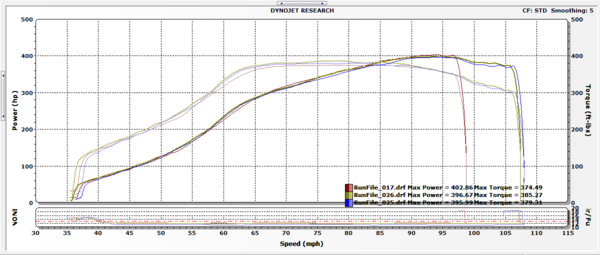

(Thread Starter) | Not Ranked : 0 score E85 adds 70HP/TQ Stage 1 tune MS CAI2 TPMS TIP Stock turbo EGR delete Turbosmart BPV CS TMIC MS CBE Fuel pump OEM Downpipe Racepipe Map sensor From a 91 octane Freektune map to an E85 (E22 mix) tuned map, I gained 70HP. That is all. |

| Not Ranked : 0 score That's pretty amazing for those mods. Excellent

| Not Ranked : 0 score Dynojet correction factor. See what a 1.01 correction factor comes up with. Great gains. I'm lucky enough to have an e30 pump close to home. Love the e.

| Not Ranked : 0 score dynojet CF = 1.09 so with CF = 1.01 you have about 315/370

(Thread Starter) | Not Ranked : 0 score CF 1.03 |

(Thread Starter) | Not Ranked : 0 score CF 1.01 Not sure which is more accurate. |

| Not Ranked : 0 score CF=1.01 is the "de facto" correction factor for our cars.
