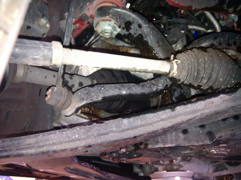

I drive straight home and this is what greets me: (engine was lopsided in bay, I immediately propped it up with my jack)

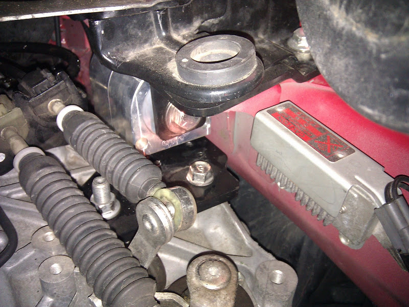

The engine mount has actually broken apart!!

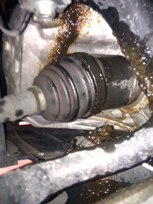

The engine slumping in the bay has caused the CV joint to rub against the suspension...CV joint is indeed fucked
So it looks like this mount lasts about four months. Installed it in January and it has now failed. Awesome

Mazda no longer produces or supports (or whatever) the CV boot that is messed up. The dealership has no choice but to order an entire new axle.

Did the black allen bolts actually break/back out over time/stripped threads? Cpe put a bulletin about applying some locktite on the allen bolts but it is a bit of work for those who already installed the mount.

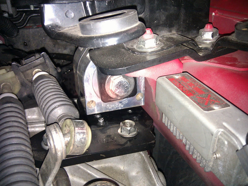

The big silver bushing is held to the black plate by 8 little screws (You can see two of them in one of the pictures)
Three of them are still there. Five have just fucking vanished

holy shit...looks like the bolts holding the bushing housing down completely snapped. did you put them all in and torque it down properly? you definitely need to call up cpe and get this addressed. if all the bolts are screwed in, that means they need to provide stronger bolts...
EDIT: nm...looks like they backed out?

yes, but did you loctite those allens?
bulletin - cp-eTM xFlex Engine Mounts Recommendations and Notes

So those eight little bolts are the only thing holding that plate to the bushing? Why wouldn't they somehow weld the bushing to the plate?
Yes. The plate on the bottom is then secured to 3 places on the transmission. Plate on top sits across the bushing with the bolt going through the bushing and the mount then mounts to 4 places on the frame rail.
