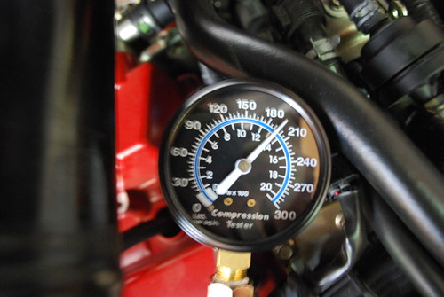

So if I'm understanding you guys right, I should be smoking pretty bad? I mean, if my rings are so worn or whatever that I can only produce 130 psi in each cylinder, would that mean a lot of oil blowby and therefore smoking?
Which if that's the case, then I'm really stumped as I have VERY minimal smoking only at idle and it's actually pretty hard to see. Most times I can't see it, but can smell it some. The thing is though, even that smoke didn't start until I installed the OCC just recently. Other than that I have never smoked and even with that, it's so light you can't really see it most of the time.
Also if I'm understanding you right, I should be consuming oil? That is something I can say definitively that doesn't happen. I do not use a single drop of oil! I also use very high quality synthetics. Currently have a fill of Redline 10w40 synthetic in it.
Knowing all of this, anyone have any ideas what might be causing me the super low 130psi [150 wet] compression on all cylinders?

I just am still surprised as to why my cylinder 3 was the highest compression- if I labeled cylinders 1/4 the way other way around, then 3 would be my lowest... just double checking.

shpankey, yours is a very odd case. Do you have a catless exhaust? Do you have oil residue in the valvacover vent going to your intake?

I did put a test pipe in, which removed one cat. But that's as far as I've changed the exhaust. No other changes to it other than that.
I'll check again but I haven't noticed any oil there Lex.

My car doesn't always smoke and when it does it's barely. I have to bend down to the pipe and get real close to tell if it even is. But I can smell it sometimes when in the garage. But it didn't even start smoking like that until I put on the OCC. I've had the test pipe on since the beginning and it never caused any smoke issues.
p.s. I meant to mention this earlier. But my oil dipstick smells like gas BAD BAD. Like I'm sniffing straight fuel. I just put this oil in last weekend. Redline 10w40. Should it smell like fuel this bad already? Maybe this has something to do with my cars issues.

unfortunately you are describing compression leaking from the combustion chamber into the other areas of the engine that hold oil - when compression gases are getting mixed in with the oil the oil will change colors very quickly after a change & can smell like gas..
what strikes me as odd about your situation is the way that you have low numbers across the board - usually when it's fail it's just 1 that is much lower then the rest.... that's usually what happens when you have a head gasket leak...

After you do your test like you did normally. Add a teaspoon of some 30 weight oil into the plug hole and restest. If you are having leakdown issues, your number will go up a fair amount (for instance my normal test was 130, when I added the oil it was 150, which indicates a real problem).

what kind of compression loss should one see from a leaking injector seal? just how much is missing?
First K04 in the 12's
First MS6 in the 11's
Certified RichTune E-Tuner
 Old 04-15-2010, 02:17 PM   #96
Probably not much. Combustion pressure is MUCH higher than just compression. If the seal was leaking under just compression, you'd hear/feel it all the time with the motor on. Did you ever get around to testing your motor?
right before i went BT i tested 180's across the board. i thought my friends injector seals were done but his compression was low on all cylinders so i wasent sure exactly how that would be affected by injector seals. doesent the piston rise up above the injector or no?

Nope, piston is always below the injector.

did a compression test tonight;
2008.5 mazdaspeed3, 35,000 miles (literally)
cylinder pressures:
(pass side)
cyl 1 - 182psi
cyl 2 - 177psi
cyl 3 - 175psi
cyl 4 - 178psi
(driver side)
b/c i was doing the test alone, i'm actually pretty sure all of the pressures were around 180-185. the reading was declining before i even got from the inside of the car to the engine.

Pull all plugs... connect gauge to one cylinder. turn car on. push ghes and clutch all the way in...crank until the gauge is not rising anymore. you can have a friend check it or set it so you can see it from inside the car, then read the number, release the pressure in the gauge to reset it...and repeat.
My battery sucks so I hooked up jumper cables to another run that was idling while I did it. Or hook up a battery charger or something.

Got around to testing mine this morning when I changed spark plugs.
2006 Mazdaspeed 6
Close to sea level. 30 feet I believe.
72,000 miles
19psi daily driver. Damn near fully bolted. Synthetic oil since 32k miles.
Cyl 1 - 192psi
Cyl 2 - 192psi
Cyl 3 - 192psi
Cyl 4 - 192psi
All were 192psi dead on. Engine was heated up. Actually drove the car 10 miles before I came home to pull it apart.

 Old 04-29-2010, 08:30 AM   #119
Great compression for the mileage. Must take care of it well!
2006 Mazdaspeed 6
72,000 miles
Cyl 1 - 192psi
Cyl 2 - 192psi
Cyl 3 - 192psi
Cyl 4 - 192psi
djuosnteisn (04-29-2010), Qwik6 (04-29-2010)
 Old 04-29-2010, 09:53 AM   #120
Jarods7920's Avatar
Location: Imperial MO
Posts: 1,415   (View Stats)
Rep Power: 582
Thanks: 127
190
190
190
190
11k built engine. Minor boltons for another week. 440 ASL. Engine was warm.
