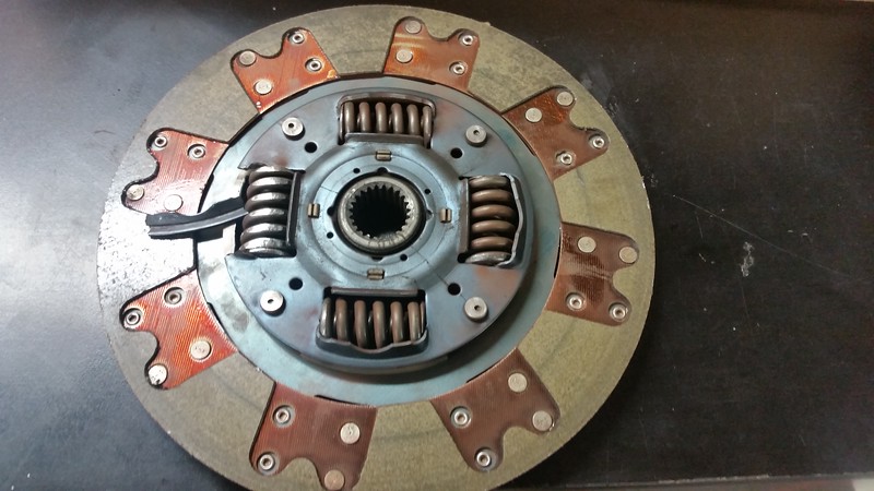

Update for ya!
Pulled the transmission today and checked the throw out bearing and it was fine. Next thing I did was head to the clutch and removed the pressure plate. After first inspection all the fingers on the pressure plate looked perfectly fine (shew). Once I removed the pressure plate a piece of metal fell on the floor. Here I discovered the clutch disk has a broken retainer clip on one of the springs. This would explain why I had the issues I had when trying to engage the clutch.
Well now I have all new hydraulics, a new throw out bearing which just arrived today that i'll install just because I have it and the tranny is out and now I'm hoping Southbend will warranty my clutch disk even though I'm outside a year old and because I only have 21,000 miles on the clutch. I dont race, I dont go into boost very often and I drive my car pretty mild. Sucks that this only lasted 21k miles. I would expect a lot more from a $1,200 clutch.
Here are some photos for ya!
Carnage:
Tons of meat left and still looks brand new!

Wow crazy!! Clutch and pressure plate look new still. How's the flywheel look?
flawless, looks brand new as well. AS you can see It's in perfect shape yet so not sure why the damn thing broke.

Here are some more photos of the condition of the clutch disk, pressure plate and flywheel.

Southbend is taking care of me! They said I am the first to contact them regarding an issue with this clutch. They have no other reports of problems and because of this, they are sending me a new clutch disk. They said my clutch disk was the first generation disk they released and they have since redesigned them. The new clutch disk i'll be receiving will be quieter and stronger they said, so thats a bonus!
Besides this little issue, anyone looking to buy Southbend for their car, I would still highly recommend them.

They covered it. From all the photos I sent them of the pressure plate, flywheel and clutch disk (as noted above) its obvious i did not beat on my clutch. Due to the minimal wear and tear of the clutch and for the clutch disk to be cracked in 3 of 4 springs they figured it may have been a defect right away. The clutch disks they use for our clutch are some of the highest end disks they manufacture so for them to see it cracked like that was very out of the ordinary. This is the first report they have seen of a broken clutch disk so they are covering it for me which is great even though I'm out of the warranty period they still covered it.

Just got my replacement clutch disk today. This disk is definitely different from my old disk.
First thing I notice is its made in Japan by Exedy. My old disk has no manufacturer information on it so I'm guessing it's made in house at South Bend.
Anyone else with a new southbend clutch also see the same on their disk?
Anyone know what version stage 3 disk they sent me based off the part number?
Pictures of the two disks for comparison.
