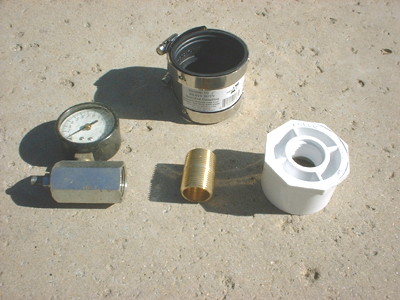

I used something like this on my old DSMs. Was like $15 to build at Lowes.
You have to have an air compressor or access to one. Connect that to do turbo, or you could probably get away with hooking it up to the turbo inlet. Then pump air into it and try to get to 10psi + on the gauge. And then listen for leaks.
here's a build thread.
http://www.dsmtuners.com/forums/arti...ternative.html

TERRIBLE for your turbo bearings, but it works. Colder plugs work to reduce pre-ignition due to advanced timing for a more controlled burn. Denso is the way to go, either ITV22 or ITV24, as they come pregapped.
