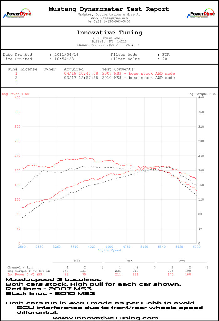

I have a question.
Would a less than perfect chain tension have an effect on power?
This is me 07 vs a 2010. In text I'm run no.1. We make the same power, but I make 22 more lb/ft. This would almost make me believe I have a healthy stock motor, but, if the chain tension does not have any barring on output, I may still need to do it.
 Old 04-17-2011, 06:39 AM   #94
easy's Avatar
Location: Rosemead, CA
Posts: 539   (View Stats)
easy is the leader of the worldeasy is the leader of the worldeasy is the leader of the worldeasy is the leader of the worldeasy is the leader of the worldeasy is the leader of the worldeasy is the leader of the worldeasy is the leader of the worldeasy is the leader of the worldeasy is the leader of the worldeasy is the leader of the world
Thanks: 717
Thanked 222 Times in 139 Posts
Groans: 27
i don't think the chain will affect any performance as long as the timing doesn't jump. If you have slack just change it. You wouldn't want it to jump timing and have your valves smash into your pistons.
