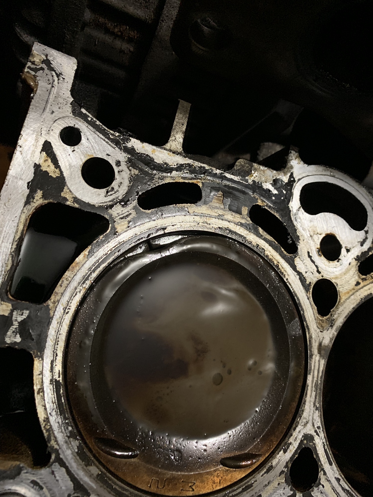

Not quite sure what I was looking at initially. The piston is definitely compromised when I went to resurface the block. Now I need to decide what to do. Part out and sell it or drop a new engine in.

now you know why the head gasket broke....instead of just craking a ring land, the heat and knock also made it melt taking the gasket with it. (or was remanufactured without being decked)
i'm curious about those pistons...i never notice the writing on mine but it is looking like a #3 installed for #1.....
Drop the pan and get it out to see how is the cylinder wall but....humm

@jeff23spl It’s a 2007 so the old style pistons. All the pistons say M2 on them and that’s an arrow pointing towards the crankshaft side of the engine, not a 1.
