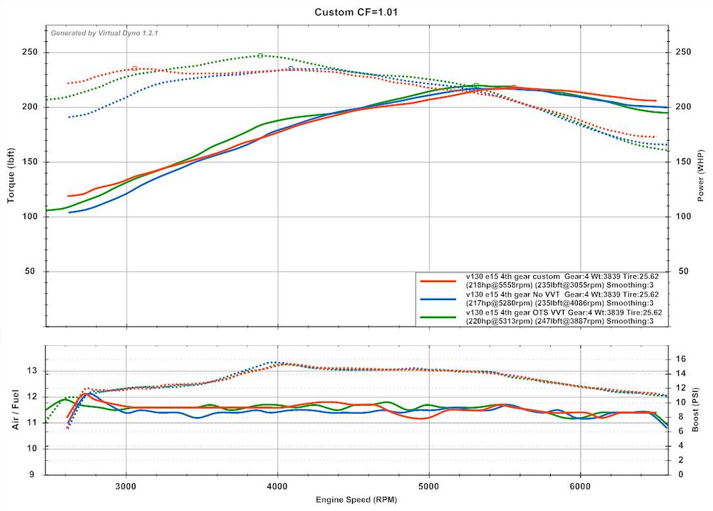

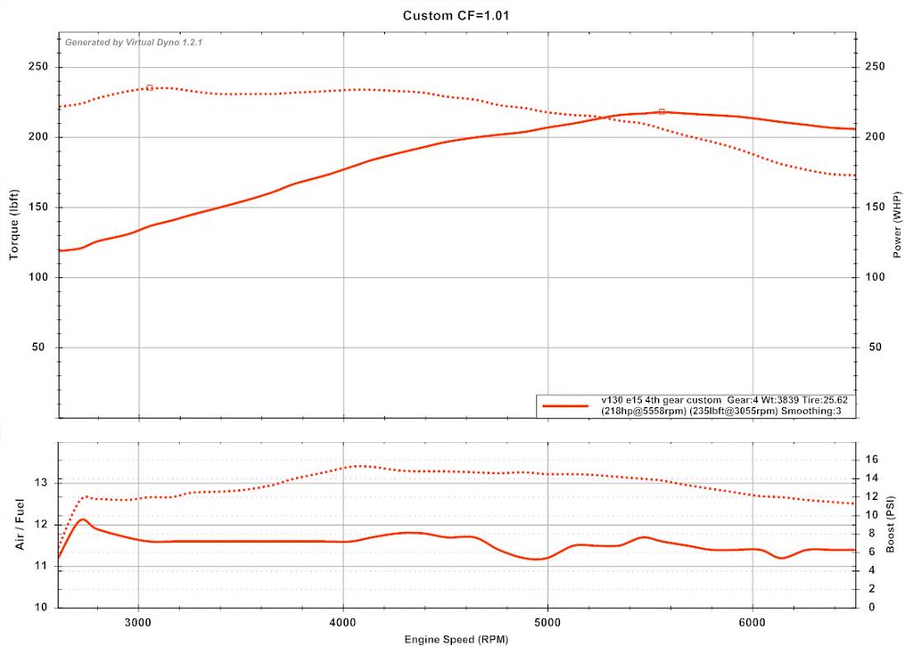

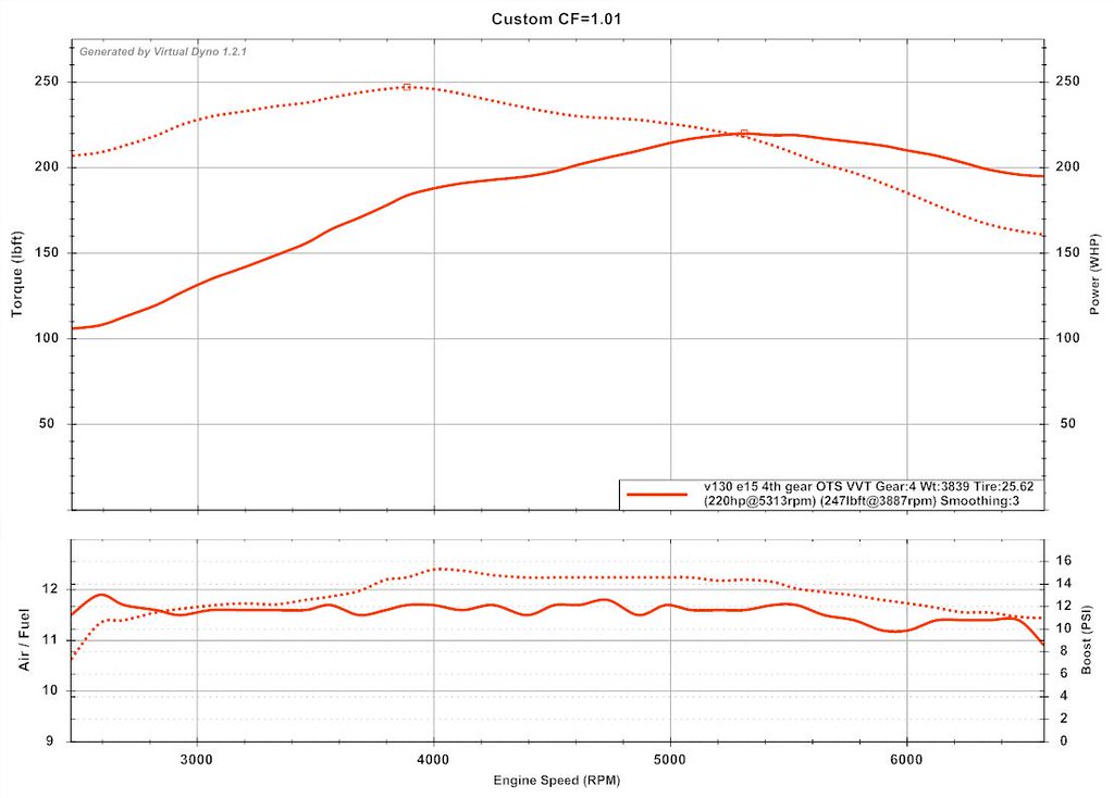

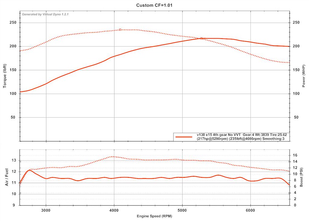

This is prob the next best thing
It's not on a dyno, but it has all the pertinent information.
Basically, 30's on the VVT make the intake valves open up earlier (BTDC), increasing overlap, low end torque, and dynamic compression.
0's on the VVT make the intake open up later, up to roughly 2* ATDC, decreasing overlap, push power to redline and reducing dynamic compression.
I've always had the occasional PT KR pulling away from stop lights, and so i went ahead and expanded the region of zeros in the VVT here:
See that upside down triangle of low values around 2500-3000 rpm and 0.69 load and below? I pretty much expanded this triangle downward, decreasing the values at higher loads to essentially decrease the dynamic compression.
It seems to have worked like a charm, but i also having driven my car in a like 2 weeks or so.

So I know this is old, but is anyone still interested in some no VVT logs?
I zero'd out my VVT table for a while and honestly, I kind of liked how the car felt like that. The turbo didn't spool up slower, but it wasn't so violent on spool up, like it is with VVT.
Unfortunately, you lose quite a bit of low end torque without VVT. I added about 10° of VVT back in the low end and picked up 20+ft/lbs in virtual dyno. If you're okay with that, then I don't see any reason not to zero it out. It makes the power feel more linear. I'll post up the logs and VDs when I get home if anyone is interested.

I don't think it helps with spool much, at least not in my limited experience with zero'ing out the VVT table. The boost curves in VD looked almost identical, but the the VVT definitely made it "hit harder". Like an on/off switch vs the power coming on more evenly.
Edit: I might just make a new revision of my current map with no VVT. Then I can make a direct comparison on the same map. I think I made some small revisions between my no VVT map and +VVT map. It's kind of cool how you can bump the VVT up 5-10° and watch the torque curve change in VD.
Edit #2 : I just made a map for OTS VVT, No VVT, and my current VVT settings. Hopefully I'll be able to get some logs tonight.

I did each run within 10 minutes of each other, so conditions were pretty much identical between each pull. Here are the results:
All three:
No VVT:
Custom VVT:
OTS VVT:
My settings and no VVT had almost identical results, but there was a pretty big increase in torque with the OTS VVT tables. I've attached the logs as well.
