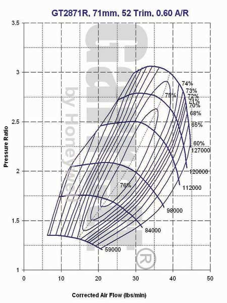

 Old 01-07-2014, 09:31 AM   #6
Where are these flow rates taken from on the map and at what temperature and pressure?
Are they taken from the edge of the last island? I took a quick peek and saw that for example the Garrett 28 frame turbos are underrated.
Mauro_Penguin (01-07-2014)
 Old 01-07-2014, 10:03 AM   #7
PapaSmurf's Avatar
Location: Homestead, FL
Posts: 8,236   (View Stats)
Thanks: 6,375
im pretty sure its taken from the turbo being in its max efficiency.
so yes edge of the last island/line etc on the compressor map.
860whp/677wtq
2.7 V6 Ecoboost
 Old 01-07-2014, 10:26 AM   #8
Above, the GT2871 is rated at 38 lbs/min.
As you can see in the image above that relates to the edge of the maximum efficiency island (76%) and not as much as the turbo can ultimately flow which is around 45 lbs.
We often run these turbos well past the middle island and make power with them well past that thanks for cooling from intercoolers, WMI, and DI.
If we could only run 38 lbs worth of air from this turbo we'd only be able to get around 330-340whp (at 18-19psi on our motors) from it and that's only true if using Cali 91 octane for example. That turbo is capable of 400whp with E85 or WMI and the correct flow parts.
While some turbos in the list are rated to the very edge of operation others are rated to the centre island and that makes the comparison difficult. I would definitely consult the full map before deciding on a turbo. The EFR 6258 for example flows about as much as the GT2871 so it either has to be rated at 35 lbs (centre island) or the Garrett has to be rated at 45 in the list. With our cars and half decent fuel and cooling we can definitely operated outside that centre island.
PapaSmurf (01-07-2014)
