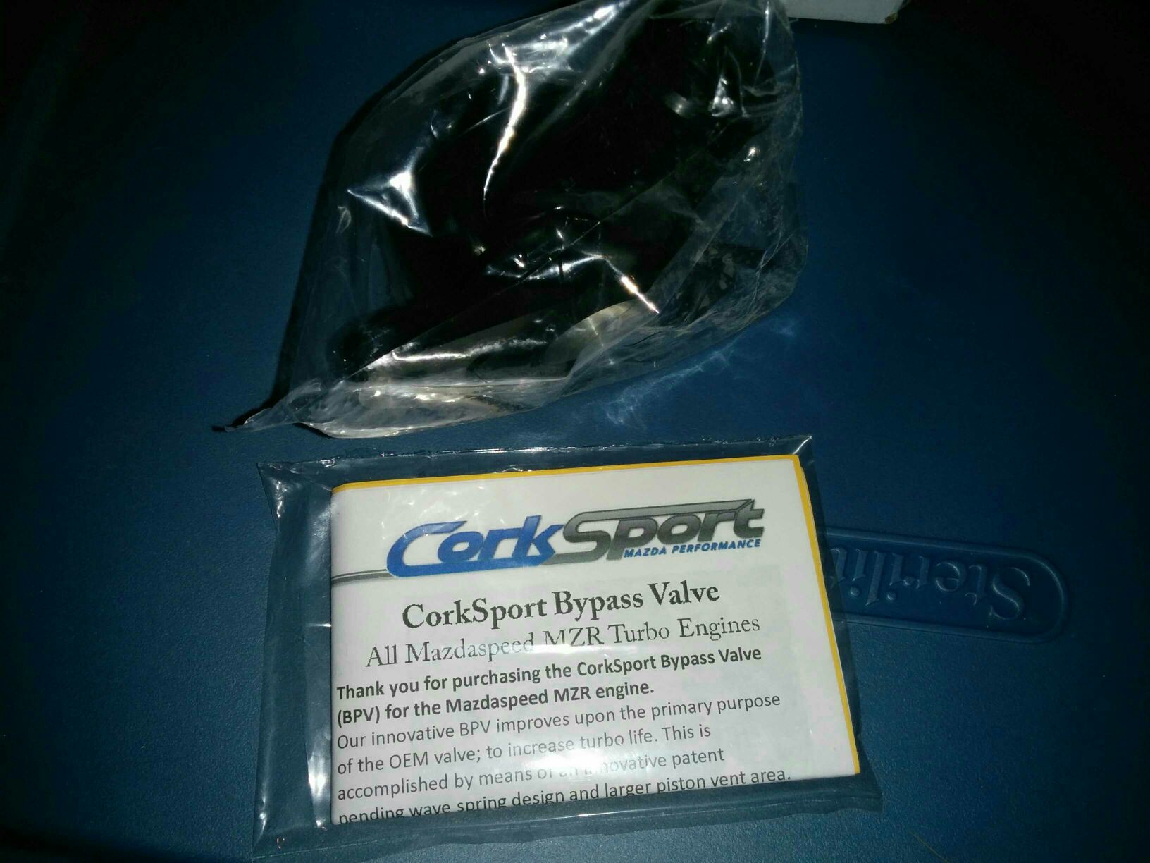

Thanks for the suggestion @Mike@Stratified! The Synapse looks really nice. I however couldn't justify to myself spending that much on a BPV.
I just pulled the trigger on a Corksport BPV. It looks like a good design (perhaps just good marketing material), was just a few bucks more than the Forge/TurboSmart stuff, and it supports a manufacturer that supports the MS platform.

I have the CS and it's been flawless at 25.x PSI, even ignoring the prescribed lubrication schedule. It's fast and effective, great price - only gripe is the small studs on the top will rust, so I ordered some stainless replacements.
Glad to see you've isolated some issues. Hopefully it's smooth sailing from here.

CS BPV installed. Attached is a 30%WGDC Map & Log.
Boost is still well below where the stock BPV was leaking.
I actually seem to be getting less boost/WGDC than before.

TMIC arrived this morning...installed during lunch break.
