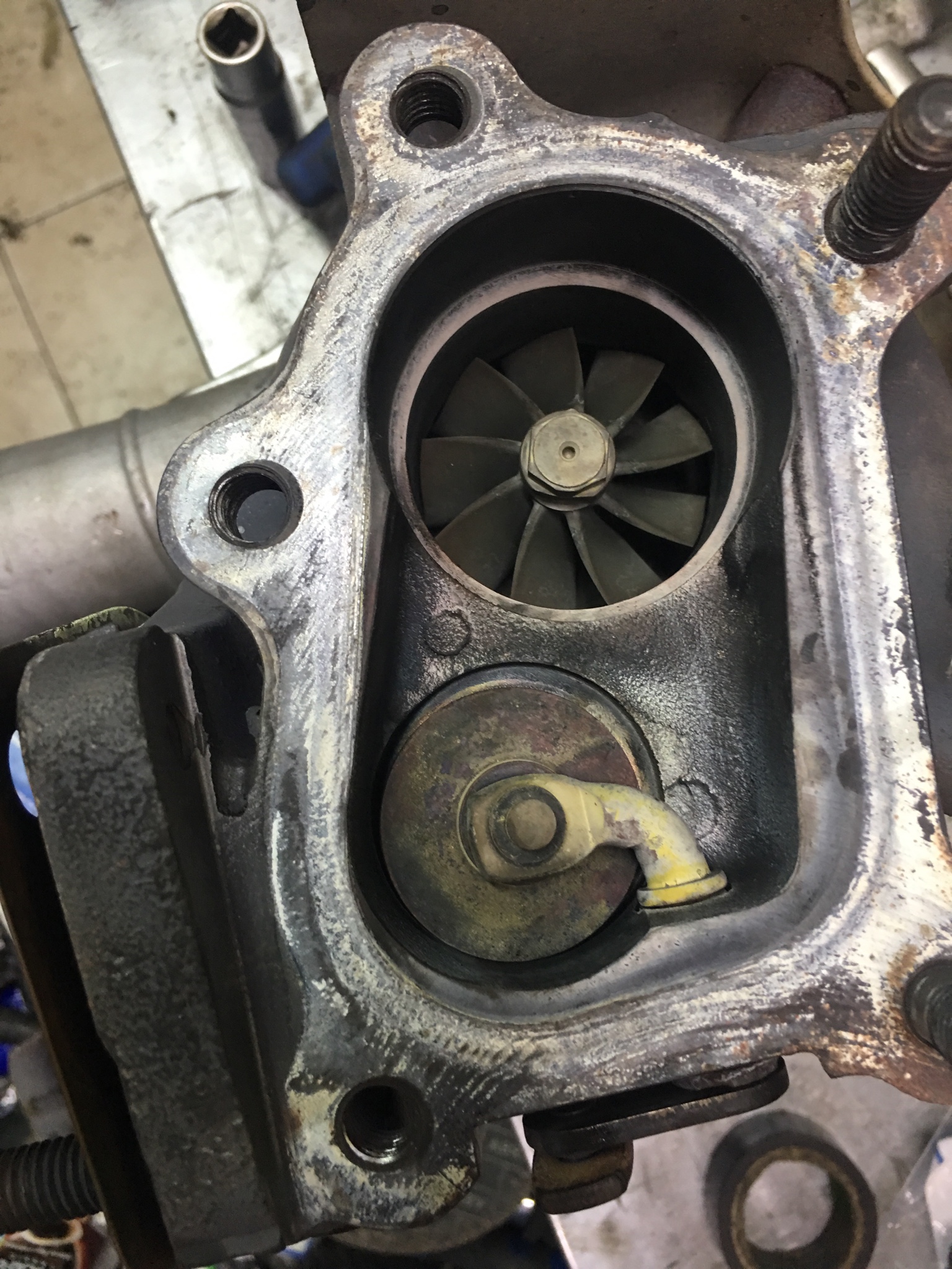

I've recently noticed that from time to time i'm not building boost at all after the CHRA replacement. The first thought was the WG actuator and rod ended up seized, but then I've discovered this:
https://youtu.be/7dvK0JTSIUU
Is this nornal, that a WG flap has so much play?
Logs will be uploaded soon!

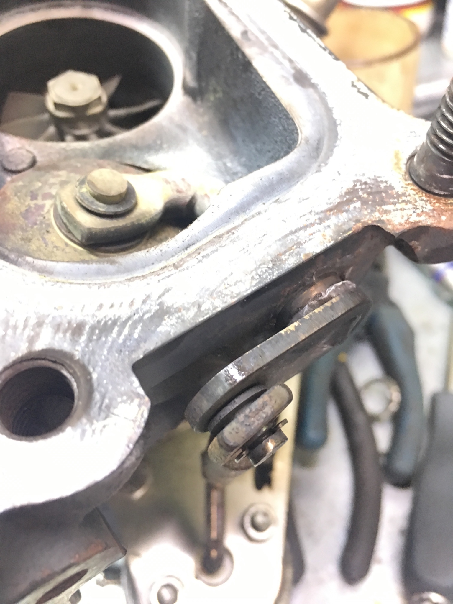

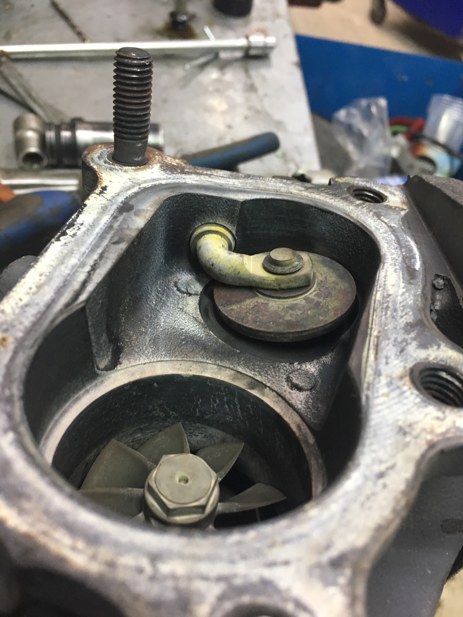

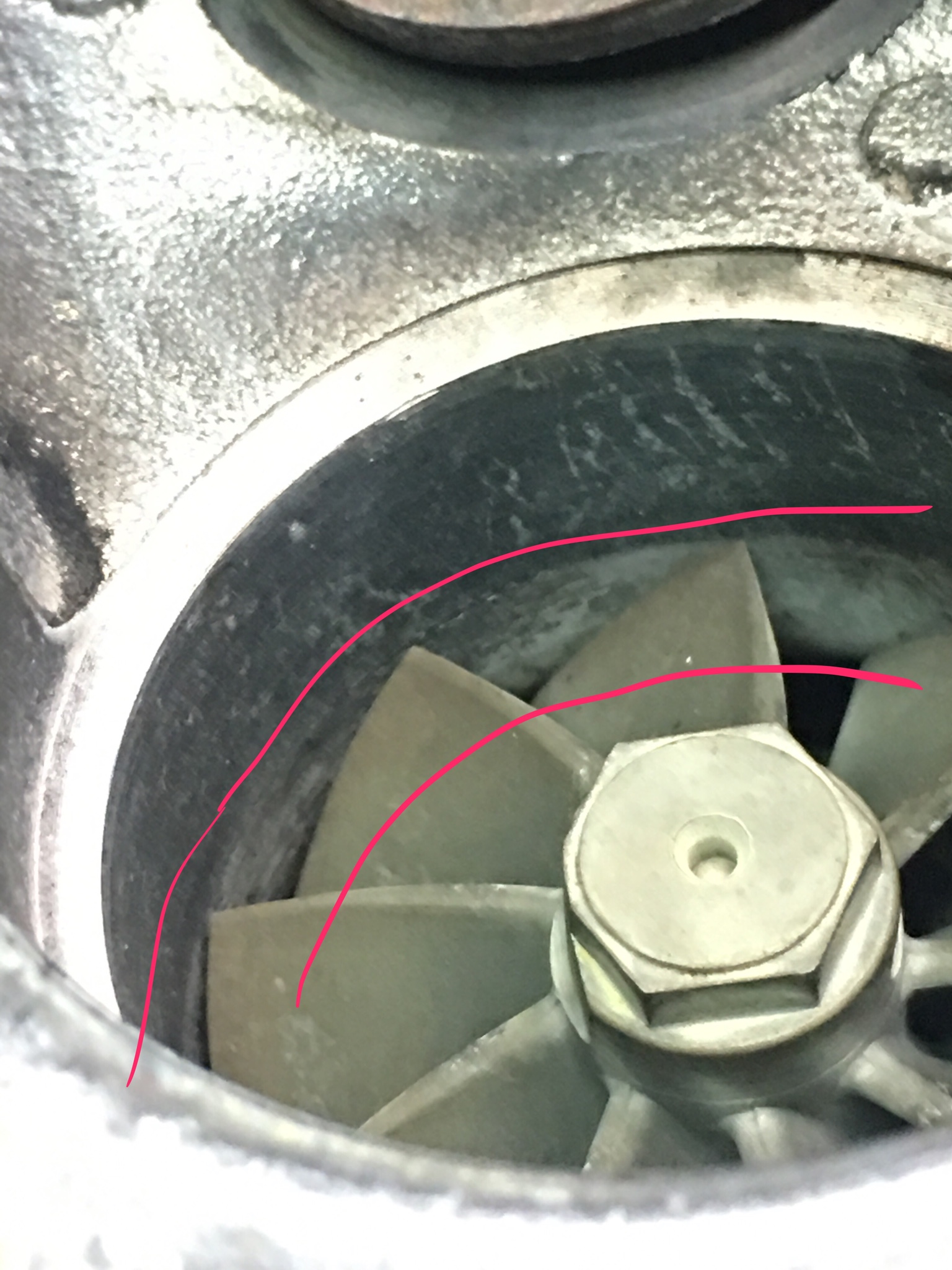

Aaaand here's the problem.
This is the second CHRA that is fucked for unknow reason plus a busted WG flapper because of tack-welding falling apart.

i recently installed mine and my wastegate is the same and makes a weird chatter when boosting.

Wow. Wonder how that happened. That's way out of spec!

I called bnr and they said that’s a common issue and I have to tighten the waste gate actuator. I don’t see why I have to do that, why don’t they do that when they ship it?
