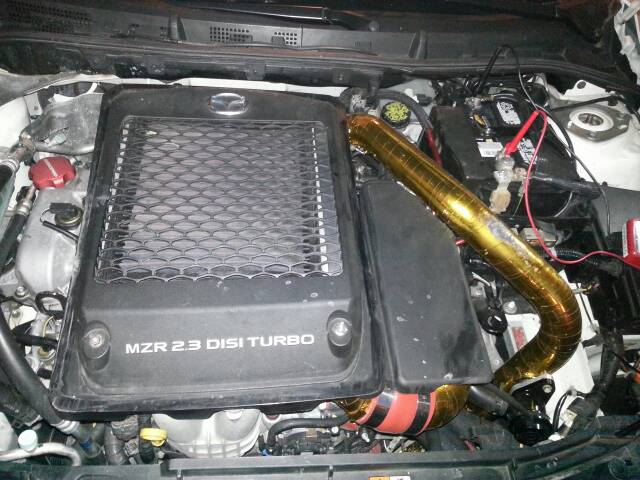

Spotted in edmonton thread swinger13 just put together his setup, BT with CS ram air and FMIC on his speed6.
I'm using the same kit, I got tuned by Lex on it. its not bad, but I do agree it should be coupled with a 3" inlet and MAF ...
idk if Swinger13 has taken any logs with this setup yet.

I do not have any rattle issues with the piping. It is on securely. I did have to have custom piping made thought to accommodate my 3.5 whale penisfrom HTP... The best intake manufacturer out there.
I am making 370whp on my tune that is not dialed in yet. I have not had any issues with the core size or piping. I have been told by a couple of the most knowledgeable guys on Msf (that don't like this product to begin with), that the core size and piping is currently not an issue on my set up.
In short, DO NOT BUY THE RAM AIR!
