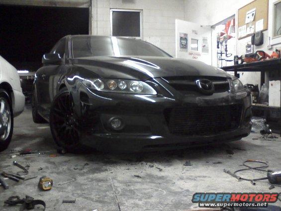

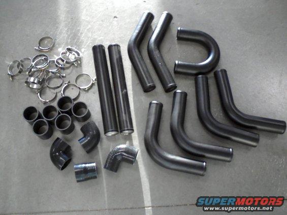

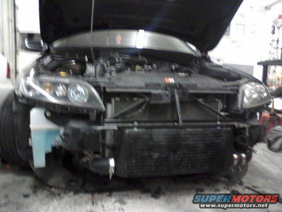

Sorry guys, car isn't getting done today. But I didn't leave you without a couple pix. This is the culprit as to why I am not getting it done today
I am heading out of town for xmas and then I will be back at it Monday. Till then here are some pix of the goods. Everything is great quality. Still waiting on my bpv flange
Sorry, I didn't get a picture of the intercooler before I mounted it. I was too excited and in a hurry. I painted it black as you can tell. I cut out 25" of crashbar and then found some angle iron and slapped it on top of where the crashbar was. Then mounted the intercooler to it.

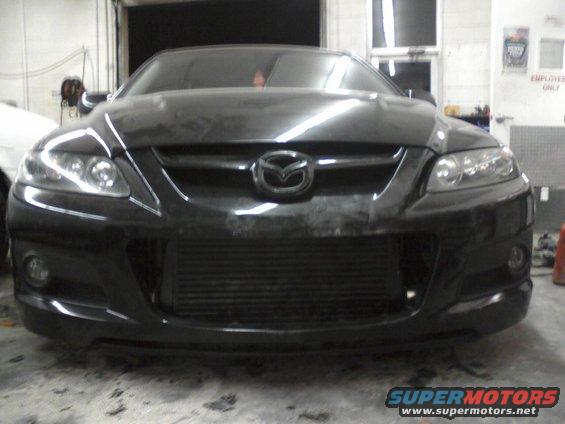

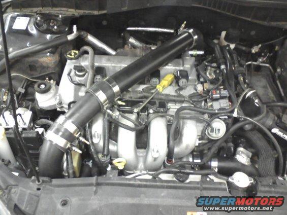

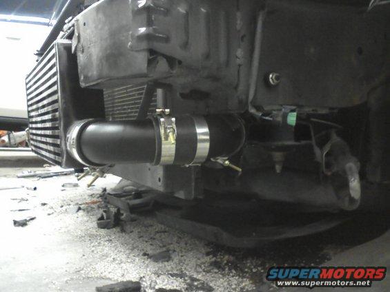

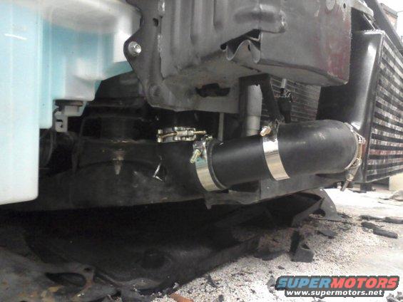

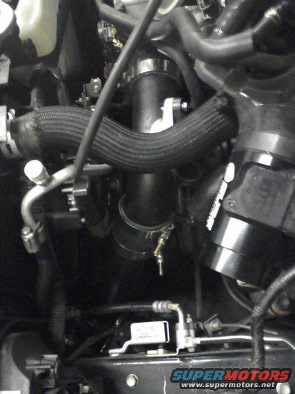

Alright!!!! First of all, this was a PAIN IN THE ASS!!!! My car has been apart for about 5 days now. I finally got it put back together late tonight. It runs and there are no leaks. Here are some pix of the setup. I had my stock bpv welded on. I will get some of the joints welded when my wife won't beat my ass for spending more moniez.
Cold side
Here is the Throttle body down. I had to rotate the radiator hose for bpv to clear
Hot side, notice you can still see the washer tank!!! woot. Also moved the horn behind ww tank
Font view all mounted. Sorry for the blurry picture
Bumper finally on

I used the 2 straights, the 2 90* pipes and the 180* pipe. that's it, had quite a bit left over.

just type cxracing piping kit on ebay. look for the kit with the free 180* pipe. here is the link
2.5" Intercooler Black piping kit 9pcs Free U Pipe | eBay
And the intercooler was from "just intercoolers" off ebay. type cxracing intercooler 29x9x3 and pick up the cheapest one. they are all made by cxracing. Here's the link for that
CXRacing INTERCOOLER ECLIPSE Corolla Turbo FMIC 29x9X3 | eBay

Sure thing man.
Thanks man. Where exactly did you use the 180? Right off the cold side?
Also, what are peoples thoughts on cutting the crashbar?
I cut the 180 into 3 pieces and used them on the coldside. There is a lot of work involved in this DYI stuff. If you go for it, be prepared for foul language, getting pissed off and some thrown wrenches. Mixed reviews on removing crash bars. They are only used for slow speed impacts. Insurance companies won't like it if their client gets in a wreck and damage could have been saved if the crash bar was still there. I say, F it.

Yeah my main concern is the insurance company and I dont really like the way it looks without cutting it.
Anyway, nice work mang, looks great. Subbed for future reference

How much space is there from the bottom of the crash bar to the bottom of the grille opening on the bumper? Your intercooler is 9" tall and you seem to have cut almost all the way to the top of the crash bar. I dont want to cut into the crashbar that much but don't want the intercooler to be in a place where there is not optimal air flow.

crash bar takes up exactly half the height of the intercooler, so 4 1/2." The top of the inercooler sits flush with the top of the crash bar. So if you mount the top of the intercooler to where the top of the crashbar was, it'll fit perfect in the grill
Hey OP so I am trying to put together a custom FMIC using a TR8 or TR10. If those are the only five pipes you used - I suppose it is still most cost effective to buy the kit rather than buy the pipes separately? The kit = $103 and the pipes separately cost roughly $95
(2x 18'' straight pipe - $14.50 ; 2x 18'' 90* pipe - $15.50; and a 24'' 180* - $35) considering the kit comes with couplers and what not it seems the better deal.

Yeah go with the piping kit. Couple extra bux and you get lots of extra material. Better enough than not. I did have to order a bpv flange. it acutally wasn't the right style. so i cut the flange out of the stock tmic piping and had a shop weld it in lol.
