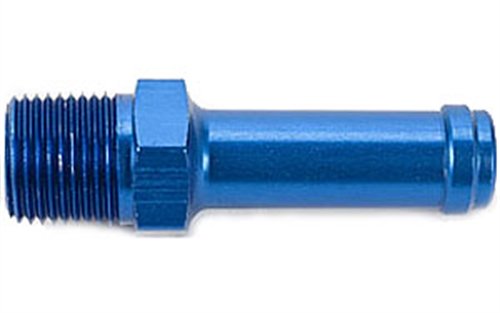

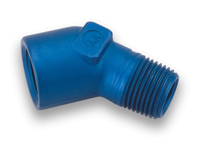

Maybe something like this, Earls part #984008 and...
Maybe a Earls part #991503...
Something like that work?
I dont know how big the ID is on -6an hose... just fyi.
I wouldnt worry about trying to reuse the factory oil drain fittings on the block. I cant remember what it looks like from memory, but you can block it off and drill and trap a hole for the new fitting if you need to.
