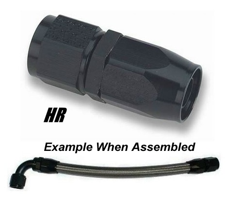

Then you just need a braided line, -4an female for that line to the restrictor fitting.

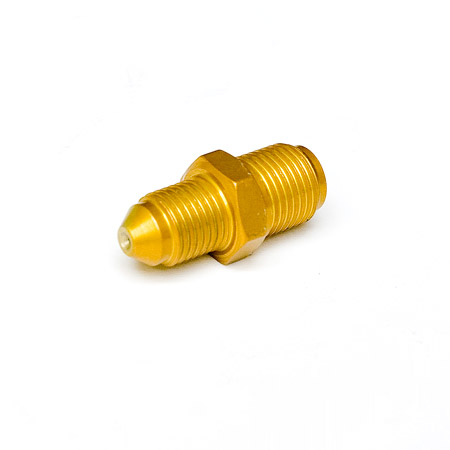

You can pick something like this up, easy to find with a 0.035 restrictor in it:
The flared end is the -4an, and can connect to the braided line, the other bolts right into the turbo. Oil feed done.

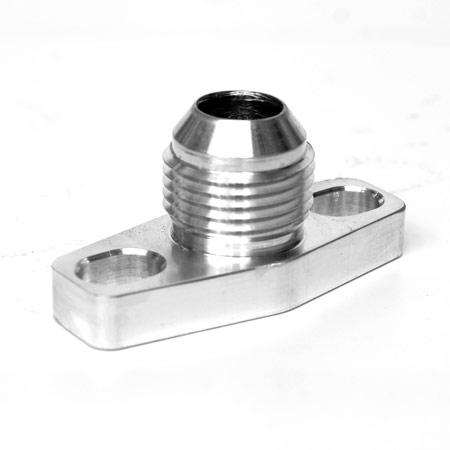

For the oil return, you need one of these, which will bolt to the turbo.
Thats a -10an (5/8"), what most turbo manufacturer will recommend for oil return lines. You have to have the correct flange to bolt to the block, so this is where a stock line would come in handy, like what SS did, and I plan to do in the near future.
Heres his -10an welded on the block-side of the stock return fitting:
Heres what it looks like as a whole, you can see the stock flange on one end and the aftermarket on the other end for the turbo, like i posted above.
and heres what the other side looks like when bolted to the block: (this is really easy to get to on an ms3, its right above the front axle.

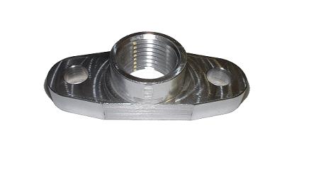

I was taking a look at that oil return fitting over at Himni Racing, and they list that fitting as being for the Mazdaspeed3 oil return, engine side.. Is that right? They actually use a female version of that fitting for the turbo side. To me that seems strange... Ie: female fitting for something that liquid flows OUT of seems like a bad idea...?
(I think they mean as a replacement for what's already on the engine)

Well, if it is a female you can just get a male to male attachment. For my turbo that is the only way it comes, so I had to do it in two pieces.
Mine looked like this one:
Then I used something like this to adapt:
This does make it a pain in the ass though, you have to make sure if you use that male to male that its TIGHT, so lots of locktite will help.

The line using the clamps is what was made by the shitty shop I picked to do my swap.. It leaked from both ends at the clamps, and was burning against my turbo manifold.. The line I made uses two full flow 45deg -10AN fittings and new stainless braided line, it has performend prefectly thus far.
I am going to run two an-10 o-ring flange fittings and ~4" of SS braid hose with two 45* fittings. It fits almost perfect but you have to run crimped fittings on the hose because there isnt enough space for hose... the nuts on the reusable ones litterally hit each other.
FYI that flange fitting doesnt really work, the bolt holes are an oval shape and it is hard to get the fitting centered over the oil drain hole. Additionally it requires a metal gasket which is not included and costs an extra $7-10. At that point its alot easier to buy the Earl's fitting which is sealed with a leak proof o-ring which is included.
I used the reusable AN fittings, but I don't have the turbo in the OEM location so my return line is considerably longer.
I ordered that same return flange fitting from ATP, it came with an O-ring already installed on it, so there was no need for an additional metal gasket. I did the install with the turbo still on the car and didn't have any issues centering the flange on the turbo..

Just started getting all my pieces together, finally... Few more questions:
1) I'm having trouble throwing on an "AN" fitting onto my SS line... Am I supposed to strip an inch of SS braid and then stick on the fitting? I'm using one of these fittings:
I've tried screwing on the end piece and it just results in my stripping this little lip that's on the inside of the connector. I tried pushing it, but I can only go so far.... I must be doing something wrong?
2) I'm not using the stock location, I've heard about people's manifold's cracking due to the weight of the turbo. What can I use to brace the turbo? The turbo itself seems to have a few mounting holes for such applications?
3) One thing I overlooked was screws/bolts for a few of the turbo fittings. I'm hoping a visit to Home Depot will make this easy... Anyone know the typical bolt sizes for a GT3076r for the oil drain? I'm trying to avoid walking into Home Depot with my turbo in hand...
4) Finally, check this out... This is the flange I'm using. The gasket that was sent to me seems to be smaller ID then the flange itself. Do I have the wrong gasket or is this normal? I can't see how this would be normal, but wanted to get some input from you guys.
That little lip you see on the bottom of the flange is the actual gasket and the lip really is there, it isn't a camera angle thing.... I could draw the two on paper, but I think you guys get the idea.... Wrong gasket, right?

Okay, I figured out the gasket issue. Apparently I need the "7cm" gasket instead of the one I have... $20 gasket, $60 shipping charge... Yay me.

1) You do not remove any of the SS braiding. I used some earl's hose assembly lube to get the hose to slide on. It's VERY tight, but it will slide all the way down the inside of the fitting.. Make sure to NOT overtighten the fitting when you are assembling it.. It will leak if you overtighten.. Also, the SS hose will not "twist" for you to align the fittings when your installing the hose, you need to make sure you clock the fittings properly during assembly,
2) Any bolt on holding the CHRA to the turbine or compressor should be strong enough for you to use for a support bracket..
3) I don't know off had, but I called ATP several times when I was ordering parts and their tech line was always helpful--even when I was just after info and not buying anything..

To add to what ssinstaller said, you can also wrap some masking tape around the hose to hold the wires and use a fine tooth saw to cut through the masking tape and make a clean cut through the hose.
If the SS wrap gets frayed you will never get it to fit.
I tried that and gave up..
I ended up using an cutoff wheel on my air grinder, I could not get a saw to cut without fraying the hell out of the braid...
