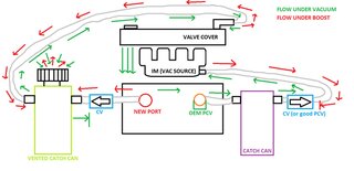

Default Dual catch can vs catch can and breather cap
What is a better option. I thought running one catch can vta with the perm pcv plate and one occ non vta was the best setup previously. I now see people running one catch can and one breather cap on their valve cover.
Does the simple 1 occ and breather cap system solve the excessive crankcase pressures?
This is the setup I thought was to be the best solution:
Any help or info clarifying will be greatly appreciated.

Just replacing the oil cap for a vented cap is substantially easier than installing a second occ.
But in my case, I get a shit ton of blow by from the valve cover, so the filter would just get covered in oil in my setup. Thus I opted to add another catch can to catch the oil.

Leaving the valve cover vent connected to the intake is best because it allows for a slight vacuum to be pulled. The vast majority of the blow-by oil produced by these engines is in the part-throttle PCV circuit, not the WOT valve cover circuit.
I'm running a PCV plate with two outlets and two cans. My routing is in my signature; it's probably different than what most people run. I collect a little bit of WOT oil in the #2 can, even though the valve cover connection doesn't go through the can, and I don't have oil in my intake, so it seems to be working the way I envisioned.

Ya I think ima run it like my diagram I originally posted to see how it does just picked up another occ vented for this one so I'll have one of each and I should have everything now just need a perm plate.

The vent's filter will pull unmetered air in messing with trims slightly when the block is under vacuum during cruising. That is the only issue I see but for most NCE since it will be very minor.
If you want the best of both worlds a check valve built into the vent's filter would solve that like a vented oil cap.
If u run the vent to the connection on the TIP you wont have to worry about that nor the smell that comes with venting a CC.
My setup for the second can has the Valve cover and the post CV hose off of the block going into a TEE then into the can. The cans exit goes to the tip.

i added two 10AN ports to my valve cover. running them to the ground or a vented can. ill run a standard oil cap and my sealed can between intake manifold and PCV. she will breather and no extra lines to stuff under the manifold.
do u run a modified pcv plate or u don't have to cuz u use the AN fittings fitted on the valve cover?
Oem plate. Line to sealed can.....can to manifold.
Then the two added breathers up top
Brent
And I will add that IMO this is the best setup, by a pretty decent margin.

I was going to add a OCC between VC and intake.
Already have one between OEM plate and IM.
I would do breathers but @Bat-man had said he gets gas smell in his car with just vented OCC or something and I didn't want that. But if no smell than I will just add the breathers in VC. How too?
u really think so @Realgib3; ??? if so I just need to weld on some AN fittings to my valve cover and run a vented can on tht side?
Yep, I've run many different setups from single can, single can + slash cut pipe, dual pcv plate, etc etc and I this setup has been the best on every car I've seen.
You keep the stock PCV system in tact and add enough venting under boost for anyone on earth.
You just route the breather and your second VC port to your vented can. I should have a pic somewhere.

So basically you use a second CC instead of a breather filter just to not have the filter get coated in oil? But either way aren't fuel trims thrown off like stated above?
U use a second vented CC with lines coming from the vent on the valve cover and a custom welded AN fitting or ur choice of fitting to the other side of the CC.. As for the Fuel Trims it is very minimal amount... As for the filter I have no experience with it
(only have experience with a venturi setup) and the point of this setup is for future headroom if wanted and proven success on BT applications.

Along with this I'm running a PERM plate with two -10an fittings. One line will be connected to intake where old PCV was connected, the other will run to the tank with a check valve.

O u went all fancy... These are for evos right? How are u gunna run this?
