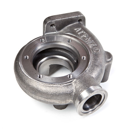

Hey guys,
As alot of you probably know there's a way to actually have a EWG with the use of an turbo housing
As i heard it wont be as "performant" as a real EWG on exhaust manifold. Anyone has tried the housing so far? Pros & cons? Apparently it is too small to achive big HP. (550+)
I just bought my self an exhaust manifold from Full race which cost me 1200$ US (so aprox 1600 CAD) and sometime soon i wanted to go BT and looking for a way not to change my exhaust manifold again since the CAD is pretty low atm.

Will not work on the speed 6 though not enough room due to the transfercase.

Good to know !! I do have a Ms3 tho =)

You'll have better boost control than with IWG but the stock flange itself isn't going to flow as well as a T3 or Vband which limits your power levels

Its going to creep, but if you're shooting for 550 or so i guess its not a problem. On a GTx3076 we had it choke and start delivering massive knock right around 32 psi, or 500 whp. It would be 0 knock at 30, 0 knock at 31, instant 6* of knock the second it touched 32, and we confirmed the hot side was in fact maxed out.
