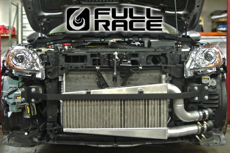

I really liked the look of the Full race kit because of it's pipe routing. I had planned to mount a large 19 row oil cooler as well as a Damond power steering cooler behind the passenger side foglight hole with ducting. I worry this will leave little room on this car for an intercooler pipe to run on the passenger side.
ducting like this would probably screw up allot of space on the passenger side.
Full race claims to use "baffled" end tanks on their intercooler, I'm assuming they just split the end tank down the middle like other manufacturers. This is why I came here, I know nothing about end tank design besides the basic shapes that would flow well.

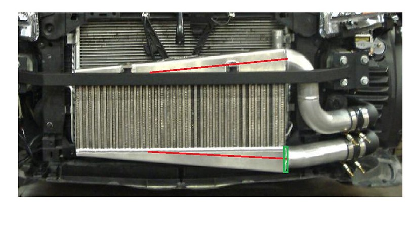

Here is just a quick sketch I did, red being the baffles and the green rectangle being a kind of velocity stack to stop air from running into a the flat section of the end tank.

If you track the car with that big FMIC blocking all the airflow to the radiator, you will be running 220-230 ECT's..... But yeah, if you want to fab your own IC, baffled endtanks have one internal baffle and that's it, I think. Treadstone has many to choose from.
