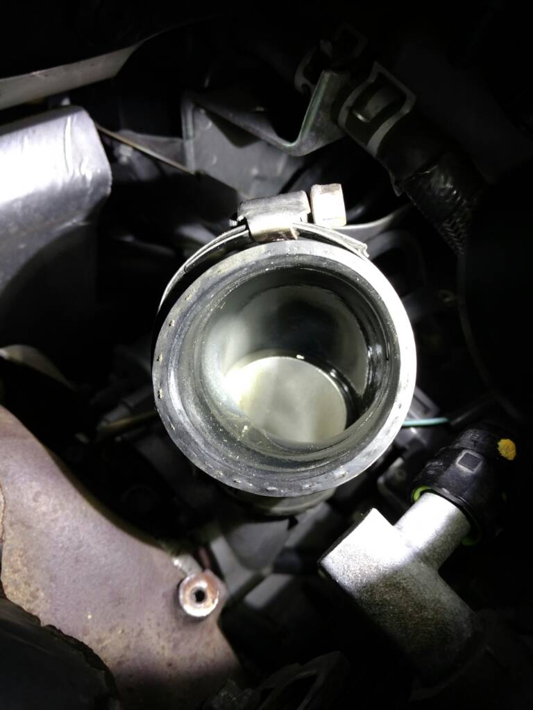

I just read through most of this thread. Having a similar issue. Car is an '09 MS3 w/ 85k miles (out of warranty) lightly modded (CPE SRI, TIP, cat back and test pipe. I smoke at idle, and also like a mofo between shifts. Consuming a lot of oil as well (prob at least a quart per gas tank).
Tried 5w40 Rotella as well as the Bnoon bolt, and absolutely no change. Car has been parked since August and I don't drive it anymore cause the smoke is so bad.
Took off the intake to check things out and there were pools of oil in the intake tract. Also tried running the car with just a breather filter on the valve cover and capped off the connection in the SRI, and still having the same issue.
The only other thing I can think of is rings, but that still doesn't explain all the oil in my intake (before turbo).
Anyone think this TSB would help me out (haven't seen anything about people smoking between shifts) or would I just be wasting my time?
Sounds like time for a BNR hommie... your turbo seals maybe leaking.
That's one other suspect I forgot to mention.
The only thing that confuses me, is I had a small pool of oil in front of the turbo, where the rubber coupler from the TIP clamps to the compressor inlet. If the seals were bad, wouldn't most of the oil be located after the turbo?

sir if i may say^^
I think you are confused, the oil in the intake and pre turbo has nothing at all to do with seals... but exactly the venting this whole thread is about, i believe what you see is the crank case vent line oil that collects in our intakes... if it bothers you too much, get a OCC
also another thing to mention since you seem to be confused(i dont blame you) but the compressor side that you took the picture of, isnt what has "seals that leak" on our platform(at least if i understand it all correctly) the seals leak on the exhaust side only, since by building up crank case pressure the oil cant drain out of the turbo, so being stuck inside of it, it has but one plase to go, out the exhaust side seals and into the exhaust, the stuff ur taking pics of, i have had in my intake for the last 80k... no problems... well cept the aweful oily mess, honestly i think its time cars started to be equipped with literal shop vacs to suck that sort of shit in instead of feeding in into the intake... thereby giving your intercooler that special thermal inner coating... lol
anyways hope that clears it up
also i notice some ppl mentioned that not having a open exhaust can "mask" the problem... thats a bit funny imho cuz i think that the reduction in backpressure caused by an open exhaust actually creates the problem in the first place(granted it appears the issue occurs not in a binary fasion but almost in a sliding scale of severity, i guess its like how do you americans say? everyone is a little gay? jk rofl, sry couldn't resist), since the pressure diff between the oil in the turbo, and the place it wants to leak is even greater when you open up the exhaust(due to lack of pressure of the stock exhausts restriction), so having a free exhaust is like putting someones hand in warm water... they are liable to piss themselves at a greater rate than average, just like the smoking turbos when paired with less backpressure
so if your car is parked because it is smoking so much, try putting ur stock exhaust on at least temporarily and see how much oil you still burn, i recon if I am right it should be at the very least less than before... but hey this is all just stuff I dug up from reading on the subject, so some of it might be just other ppls best guesses passed along, but to me it all sounds quite plausible not to mention coincides with my observations on my own car...
but you def don't need to worry about the oil in the pictures, if anything, thats a sign that your pcv is working really well in sucking all that blowby out, lol, almost working TOO WELL, based on your concern, but honestly I haven't seen a cleaner turbo outlet on the compressor side anyways
also when is the last time you seafoamed?

Originally Posted by leo766 View Post
sir if i may say^^
You need to do more reading...
When the engine is in vacuum, the pressure differential across the turbo oil seals is into the compressor outlet side. Oil can pass from there into the intake and turbo inlet via the bypass hose.
There's a reason that a lot of threads suggest that if you see oil in your manifold or in the turbo compressor inlet/outlet that you have failing turbo seals.
Seafoam doesn't do a damn thing in the L3-VDT.
