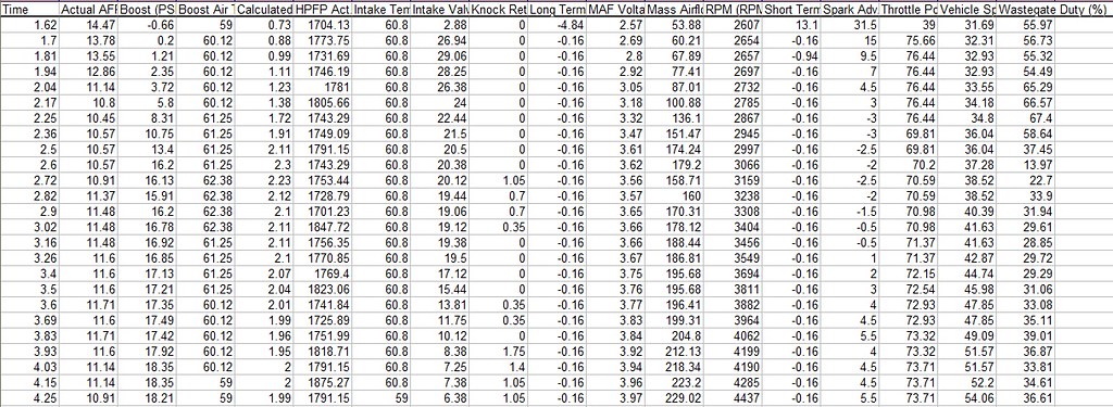

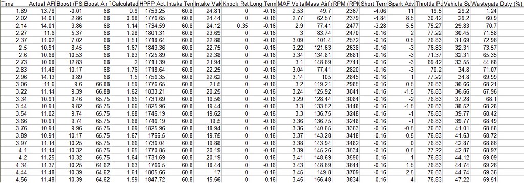

Here are some logs I took tonight with the stock bpv and the Forge bpv. I set the GA to the lowest setting.
With the stock bpv, the stock GA kicks in at ~10PSI.
With the Forge bpv, the GA LED comes on at ~10PSI, but the car easily builds boost to 18 PSI.
Any ideas what's wrong with my Forge?
