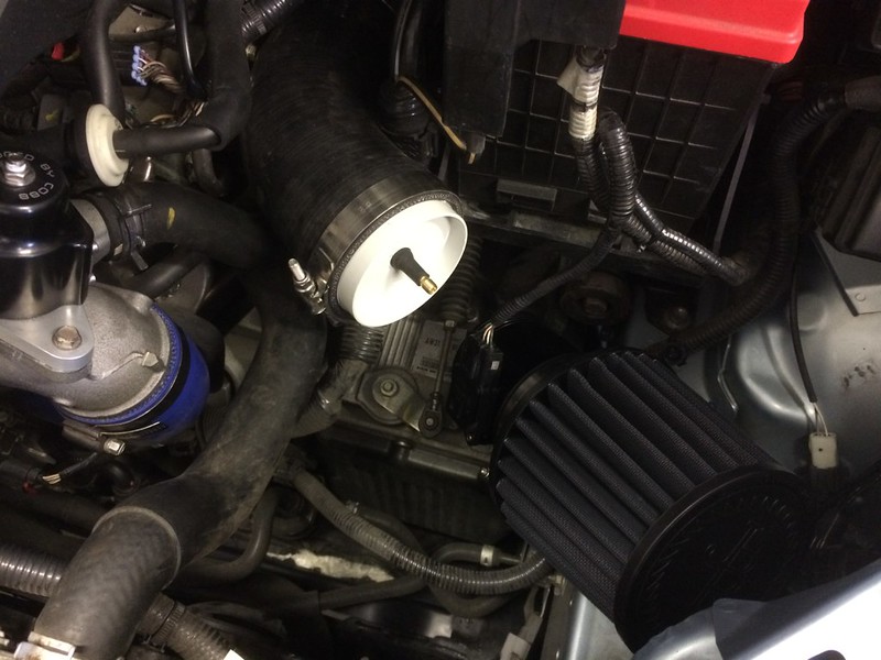

After finding this I read up all the threads on finding boost leaks and made myself a boost leak detector. Here it is installed in the end of the WPI. I used a regulated air supply of around 30psi from my compressor and a tyre inflation gauge.
Untitled by ozynigma, on Flickr
The first thing I found was my Cobb XLE was dumping boost at about 10 to 12psi. I found this with the BPV return hose disconnected from the BPV and plugged. I put the OEM BPV back on and was able to get close to 20psi before leaking boost. I figure the Cobb needs a stronger spring. i don't know why the previous owner had it set so weak.
I also found the intercooler boost tubes needed tighter clamping. At this point I was pressuring the whole intake to around 20psi and the only leakage I could detect was around the PCV hose from the valve cover to the WPI. As this is not normally pressurised I didn't try and fix it.

I think I have figured out my BPV problem. I don't think the Cobb has a problem. I used a scale to test it and it is taking about 8psi pressure differential to move the piston and 18psi to open it fully.
So the fact that I was generating the 8psi pressure differential at around 12psi boost pressure indicates I might have a leak from the vacuum/boost hose connection from the manifold to the BPV.
So the plan is to get the improved check valve tomorrow hopefully and pull the intake manifold and replace the check valve and check the BPV hose connection.
