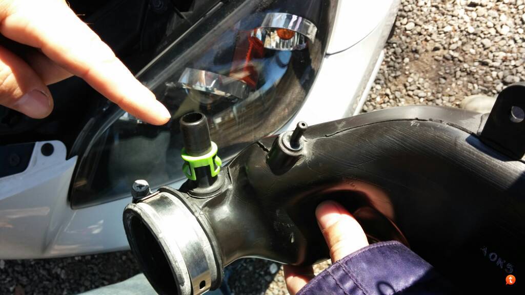

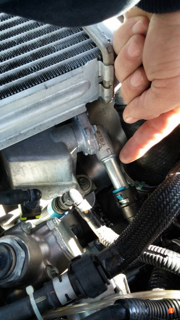

So, I have the cs tip, and I'm trying to I install. I can't find any info in any instructions or how to 's. I have an extra line on my stock Tip and there isn't a connection on the cs one. Idk what to do with it.
The other end connects here

Looks like the VC breather hose. There should be a connection for that on the @CorkSport; TIP, although it is further up from the turbo inlet. Should be able to just directly connect to the TIP if you don't have an OCC to go through first.

That's what I thought it was, but there isn't a connection. The only connections are for the turbo, intake, bcs, and recirc.

VC breather. You have to check the option for that when ordering the tip

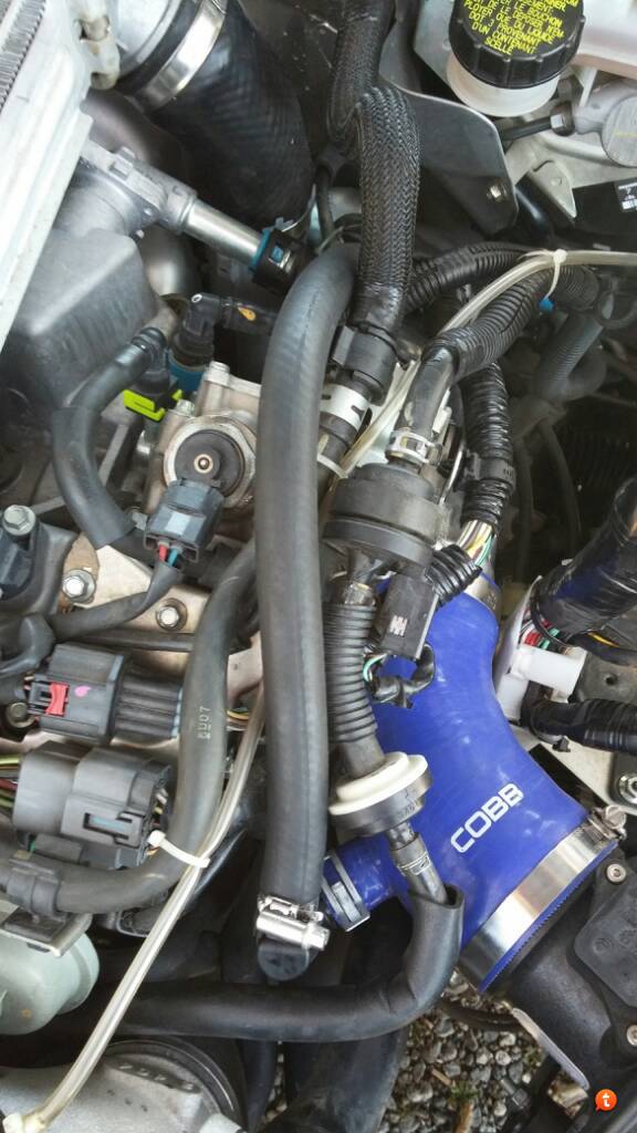

Here's how I ended up doing it, as I have the cobb Sri and there was a port just blocked off, not being used

What you want to do is connect the COBB SRI port to the valve cover vent. Then if you're still using the OEM turbo inlet pipe, plug the hole on it near the turbo and make sure it doesn't leak.

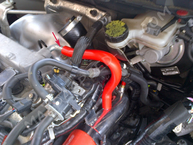

Here you go:
Hope it helps.

That's what I ended up doing, I used the stock connections, and just spliced them together w a piece of hose I stole off my blazer lol. While I'm posting, I bought my car used, and don't know if the hpfp is stock or not. I an using the torque app to monitor my pressure at the rail. I got it up to 1777 psi today, and it ran great. Is there anything in particular I should be looking out for? Or any way that I could check to see in my internals are stock or not?
