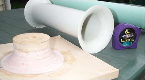

Some of the Aussie guys with big turbos use the original airbox connected to a 3" or 3.25" intake. There is no measurable power difference compared to a SRI/pod setup, but it's much quieter and looks almost standard.
The airbox inlet is replaced with a short, wide bellmouth peice and the outlet is cut out and moulded to suit.
The standard paper air filter is retained as it's not restrictive.

PERFECT that's great info thanks. Do you know where I could get some more details or some pix? Most likely I'll copy the design.

As mentioned above, the inlet & outlet of the stock airbox are modified to increase flow while still keeping a standard appearance & sound.

Yep, I'd certainly recommend using a fin or honeycomb air straightener in the AFM housing, and flare each leading edge of pipe.
Some people use PVC stormwater pipe which is easy to heat and mould into shape with a heatgun.
This website has some info on moulding PVC.

There's some decent engineering there! Last time I made an airbox I just bought an aluminium velocity stack from ebay for cheap.
