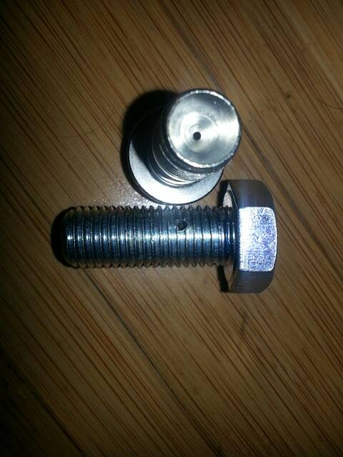

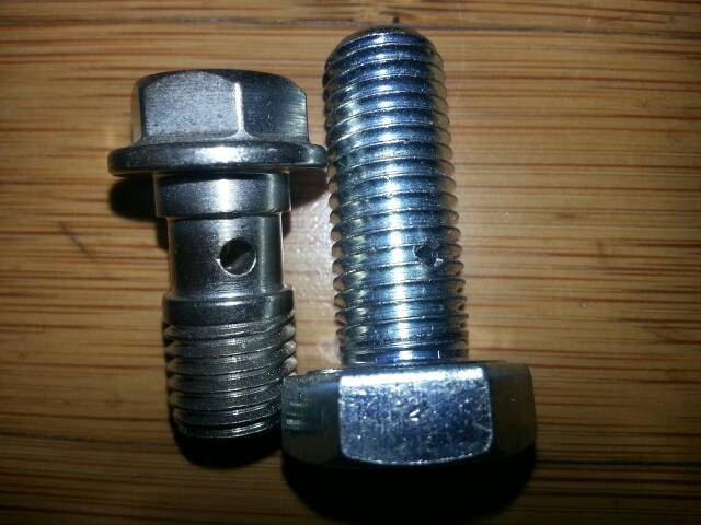

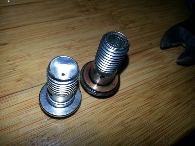

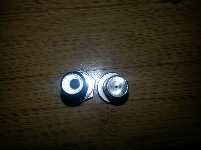

Himurax. Has see my bolt.I bought one of these.the restrictor is exactly the same as bnoon bolt.onot difference is this bolt has the restrictor on the side. Side by side with the bnoon this bolt looks like something made in a factory. The holes don't even look like home drilled type.it's a true banjo bolt.if anyone needs pics let me know and I'll use my dslr

I have this bolt and I too did a LOT of research before buying this exact same bolt about 4 months ago. Since then I DID have to replace my turbo anyways but I am still using this bolt today.
As far as the bolt size goes, Bnoon mentions in his thread about the size: "I found out after much begging and pleading that .060" is recommended minimum size per 2 rebuild shops that specialize in rebuilt KKK turbos." The ebay bolt when converted is .059" - close enough for me.
Someone in the thread mentioned what is the worst that can happen from the smoking turbo, aside from losing a quart of oil every couple hundred miles (luckily I was checking like a hawk and kept on top of that while I tried to figure a solution, well the car DEMANDED my attention with this.... My seals really BLEW.

thanks for more info
Bolt came in yesterday
... 1.5mm = 0.0590" so no work should be needed.
Got the OK to buy me a DP&TP. So i won't be installing the bolt till they come in.
MS3 isn't my DD so i can wait.

So i made a how to for the install, take a look: How-To: Install oil restrictor bolt (complete guide)

update: Has been installed and no smoke and all seems good so far

10 thousandths of an inch too small as recommended by several rebuilders of these turbos FYI. If you buy an Ebay bolt, ream it out to something closer to .0600 (MINIMUM) to .0625 area. My bolts were drilled slightly larger than the minimum size and hand reamed to remove any burrs.
