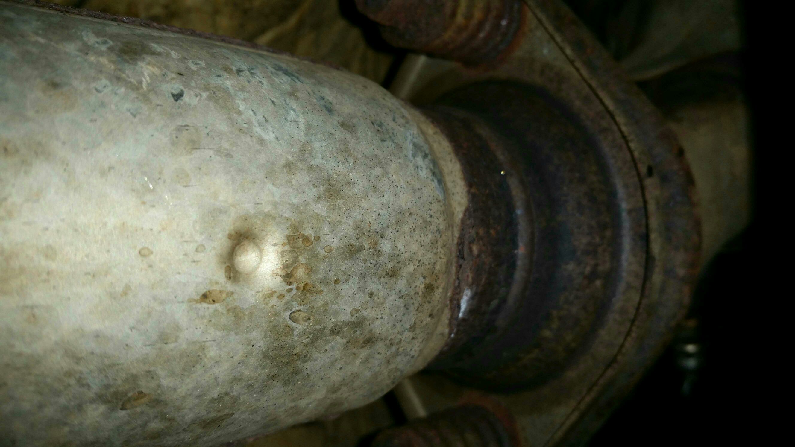

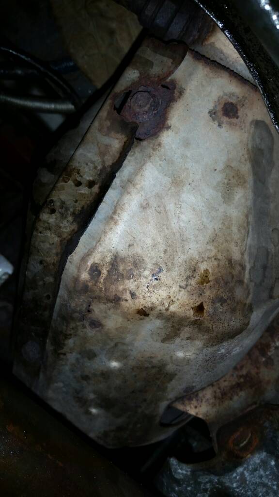

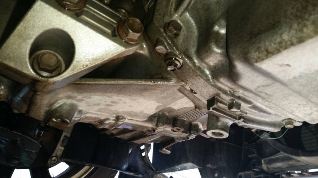

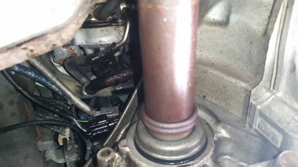

Okay so the misfiring came back and it showed its still throwing a P0300. Weird thing is, it doesnt missfire at all through first gear no matter how hard I get on it but the higher gears is where the engine flutters and hesitates, but it if the boost is only around 10psi or lower, it doesnt misfire, but anywhere above that it does misfire getting worse and worse up to 15psi. I just went under the car and took some photos. The downpipe I believe it is looks cracked open cause of rust and there's oil ALL OVER the engine, tranny, axles, controls arms, etc. so it seems theres some type of oil leak coming from the top but I can't tell where. Any ideas? I'm also throwing a CEL for a lean idle now

I'm not sure how you managed to take those pictures without actually capturing the downpipe in any of them.

That is a heat shield on the DP, not the DP itself.
Have you checked your plugs and their gaps? I'd bet that is your source of the misfire.
As for the oil leak, check the turbo oil lines. Kind of looks like its coming from around there, but you're going to need to track that down with your eyes and hands. Hard for pictures to show us much. Try cleaning all of it off, and look back at it a few days later.

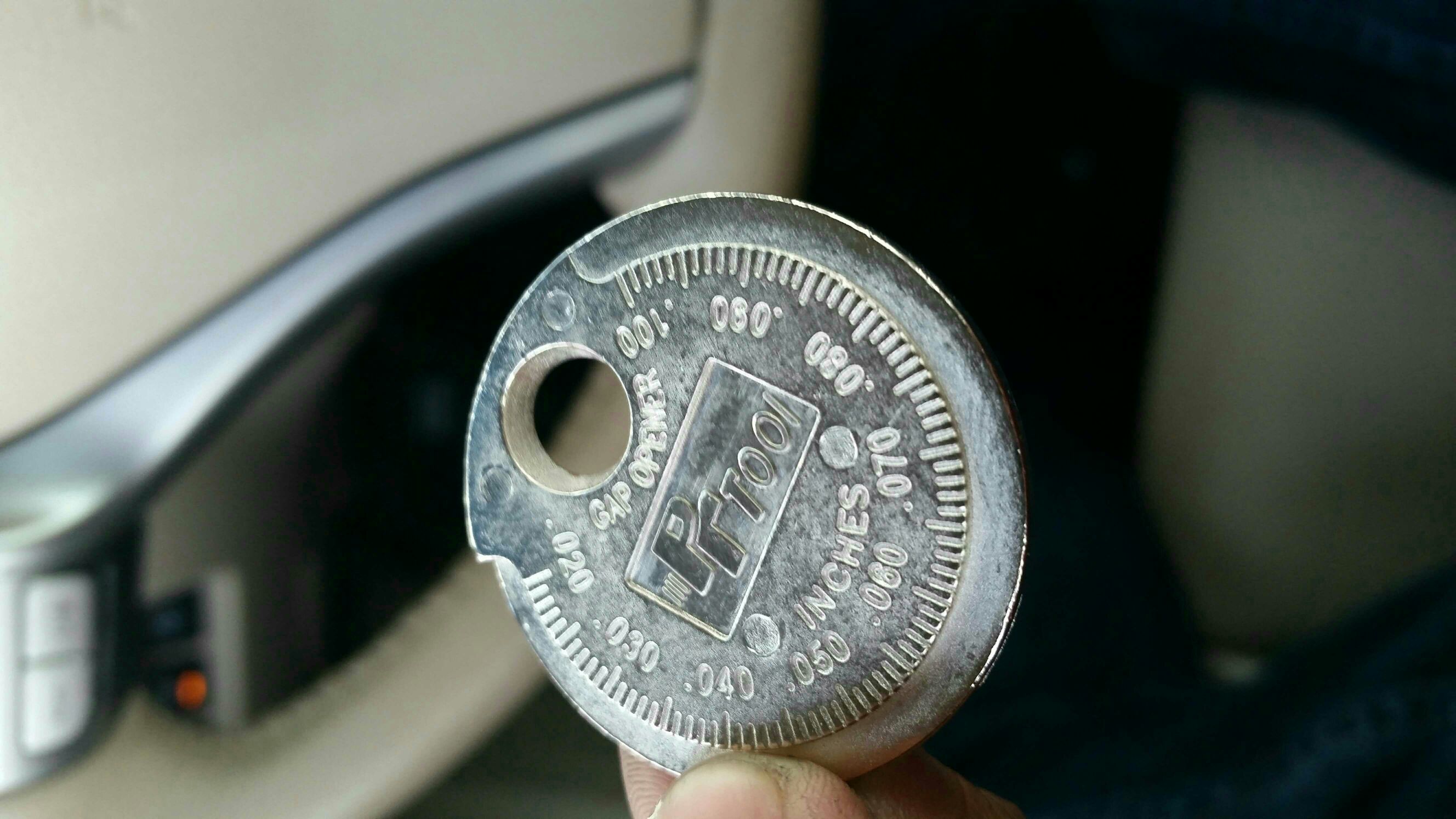

As I'm new to this stuff, I'm not sure how to check my plugs gaps. I bought the plugs that were for my car and i screwed them in until they were tight
Sent from my SM-G900T3 using Tapatalk
Alright I just watched the video on it. What is the gap supposed to be?

I just use the coin style gappers sitting on the checkout counter of my local autozone (like 25 cents). Go pick one up. They'll know what I'm talking about and once you see it, you should know how to use it. But yes, +1 on probably plugs. My engine misfired at high boost due to the wrong gap.

Picked it up! So by +1 you mean to make sure the gap is where it says 100, right?

For the love of all that is holy you'd better be joking...

.026-.028 is the gap you want. Those gapping tools are not meant to be used with iridium plugs. Close the gap down to .028 and your misfire issues will go away.
Thank you! I did that and it got rid of the misfire, but I was pushing around 15psi at full boost before and now im pushing around 12 or 13. What's the normal amount?

Those coin gap tools are garbage. Pick up a wire gauge spark plug tool. Much more accurate. Regardless, the one you have will get you "close"

What concerns me is that it has an aftermarket exhaust. This may or may not indicate other "enhancements" have been added. That's why I asked for engine bay pics. We may see something that he doesn't know to look for.
Assuming that's the only non-stock add-on, you are correct about not sweating the HPFP. I just have this gut feeling there may be more to this story.

Turns out the oil leak I had was a crappy job by whoever did the valve cover gasket so i got that done, but now im getting oil from somewhere else and while i was under the car trying to figure out where it was coming from, i had a friend rev up the engine a couple of times to see if any oil would drip from anywhere, but nothing. instead, i noticed smoke coming from the side of my turbo. that cant be normal
