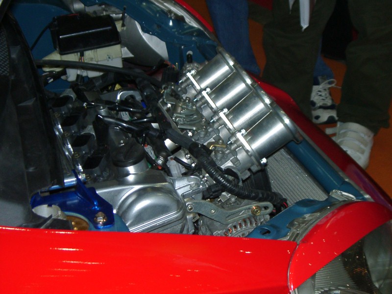

Post pics of the 1.5L beast.

It's just a running engine on a stand

Also, please put ITBs on that thing.

Yeah, I've been drooling over those lately...
