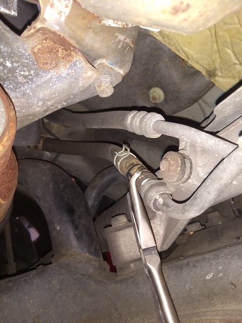

Step 4: Prepare to drain
Take a pair of pliers and move the two clamps up/left, off the rubber tube completely, to the red arrow.
Now twist and simultaneously pull the rubber/metal bracket apart, slowly, just to where it will almost come apart.
*You want to keep the top of the rubber hose attached, and remove the metal tube from the bottom of the rubber hose

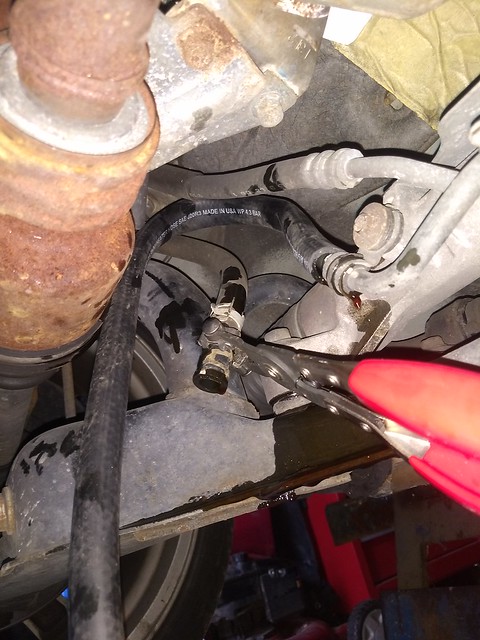

Just did this according to above instructions mostly. Also used this for reference, although the layout is not identical.
-Below is a pic of where I drained for MS3, as show by the un-clamped hose, as you can see it won't leak until you unsheathe the foreskin even after un-clamping.
-Depending on how asian you are, you might be able to get away with just jacking up the opposite side to drain.
-Used quite a bit of tinfoil to cover everything, but there wasn't a big splash, just isolate the hose and you'll be fine.
-For some reason I also decided to pour in a bottle of Valvoline Dexron Synthetic to flush, before I filled with 2.1 bottles of the above mentioned Royal Purple.
-Drained fluid stank so bad it made me gag like when I saw Hedwig for the first time, but also like that transgressive musical, I got used to it.
-Feels good man, can't notice much, but improvement is apparent, smoother, perhaps quieter lol. When I stick my dick in the reservoir it doesen't smell bad anymore when I perform autofellatio.

I followed BREAKFASTINCLUDED's example for my 2007 Gen1 Speed3. I used two quarts of Valvoline. Wuz the first flush at 142k miles.
You should put hose sections onto both the rubber and metal ends of the low pressure line that you open up, so as not to spray fluid everywhere as you turn the steering wheel back and forth.
Here you can see how I put hoses onto both ends. One hose, 5/8ths was way too large and fluid dribbled back down out of the unclamped end.
3/8ths hose with a 3/8ths barb worked well.
