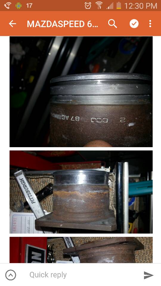

Grinding down this part on flange housing allows the boot to seat and have a lip preventing it from slipping off.
Got my band clamp tool on ebay for $15 shipped.

IMO so long as you grind down the shaft on where the flange is like post 47 and use a band clamp tool the boot will not come off, however if heat is an issue than may need to figure out way to make heat shield. Maybe put a temp probe there do get it really hot than come to stop and see how bad temp gets. IDK what the boot is capable of withstanding.

You need to groove the flange end of the shaft so the strap has a place to seat and use band clamp tool as I posted above. I think the boot may get pulled off from a hard shift when the engine moves and rather than the boot doing what it is supposed to do it just slips off the flanged end.

After reviewing a few posts about fixing our cv joint on the propeller shaft I completed two. My first one I rolled the cv boot above the o-ring lip and used lock wire to secure the boot into place. It lasted about 120 miles and blew up around 88 miles per hour on the highway. Brought it back home and determined I had slid the boot up too far and hit a weak point on the boot. I then tore it all apart, used 1/2 of the supplied grease in the bag that was supplied with the cv boot and put it back together. I slid the boot just above the o-ring groove and used lock wire again for the front and back. I also realized that you should burp the boot before fully locking the new boot into place. After securing it all into place, I didn't want the boot to burn up so I wrapped it securely with some flexible heater vent tape made for exteriors. So far 2 weeks later it's still working.
One post I read about a cx-7 propeller shaft being able to be used, the one I pulled from a junk yard didn't work. Although I do like the cx-7 shaft set up better with separating the front, middle and rear sections of the propeller shaft.
Once I have my new propeller shaft installed I'll be able to work with my machinists on developing a more practical fix for our issue versus this band aid.
Will upload carrier bearing differences later between the speed6 and cx-7.

The only way to do the repair correctly is to follow the advice in the ops post. You need to grind a large enough channel for a proper seat and you MUST use the metal crimping tool. The tool is the only way you will get the metal band clamp tight enough. Its an inexpensive tool and well worth the money. I use it for radiator hoses as well. Between the heat and the rotational velocity of the shaft its well worth the investment to do the repair"by the book".

Will do once I have the new shaft installed. This was a band aid that impressed me, I did not expect it to last this long.

Len - The beck boot holds up fine to the heat. Most people, including myself, wrap the DP anyways so heat shouldn't be an issue regardless.

two piece drive shaft would be the cat's ass but yeah, tapped out as it is with this freaking engine build.
not sure if I will wrap my DP, gonna test the waters with out it just to make more work for me later.

Reviving an old thread and not even sure if any of the posters are still with their MS6's?
I had the rubber boot around this CV joint come apart and take out the O2 sensor wiring on a drive back from NY to Virginia. I suspect that the 'debris' wrapped around the prop shaft as it made the most God-awful sounds at 80mph.
Now, I've just gotten the car a month ago and haven't really crawled in and around the car, but having done so tonight to see what had happened, I noticed that my car has a rubber boot (partially trashed) over the joint, AND the soft metal cap is in place. There's no evidence of grease anywhere, so I'm a bit confused. Did a prior owner install the rubber boot?...or was the boot in place OEM?
Next question: the wire to the O2 sensor was chopped-off right at the sensor, and the wire remained in the car caught on the tubular crossmember. Where does the downstream O2 sensor plug into the harness?
BTW, I was an original owner of an '06 MS6. I turned the car back-in at the lease termination as the buy-back was well above the car's value. But I've regretted giving the car back for years and finally found this 70,000 mile/one-owner car that is in astonishing condition. I'm (admittedly) anal about my cars, and the prior-owner was equally caring. Couldn't be happier with my return to the fold.

It plugs in roughly under the water neck. As for the boot, that sounds like an owner install and already determined to be a shitty way to do it. They're all torn, we just send it. I may try a silicone reducer, but the only permanent fix is a driveshaft shop one piece shaft
