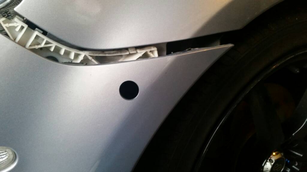

1. Remove bumper in whatever fashion is applicable to your car. (Multiple write-ups for this)
2. According to your issue, determine what part of your bumper needs reinforcement. For me, I ripped off the eyelet on the passenger side of the bumper where it meets the fender the first time i took the bumper off. I Had a temporary repair that lasted the better part of 2 1/2 years but when i saw these it was obvious that this is a more permanent solution.
[IMG][/IMG]
