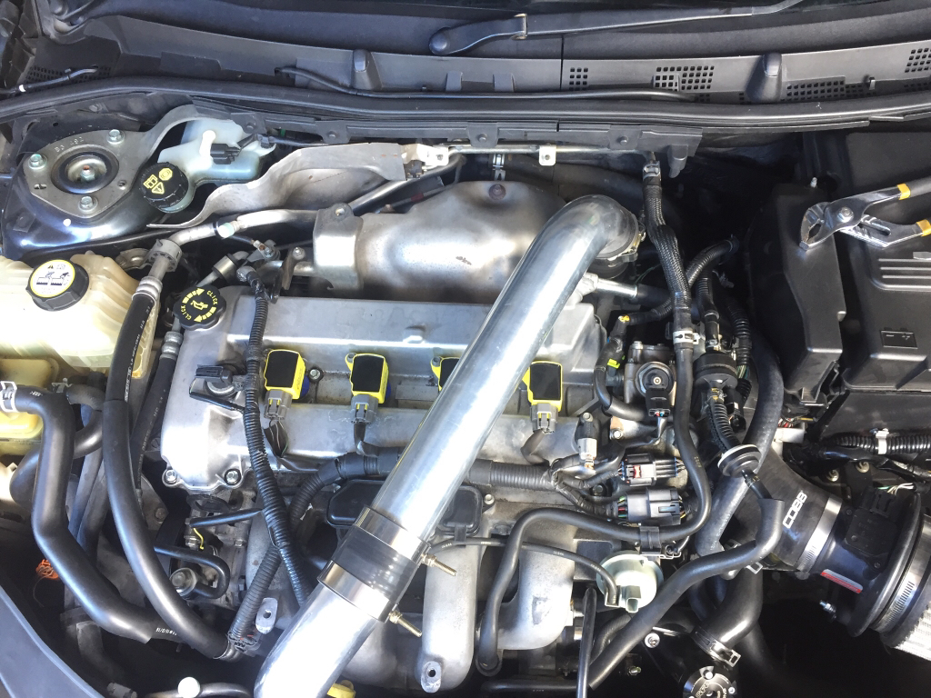

I couldn't see any valve in the intake side of the vacuum line, checked he line next to the HPFP.
Could you please send me a photo of what I am looking for or is it really different
FSRRM is offline   Reply With Quote

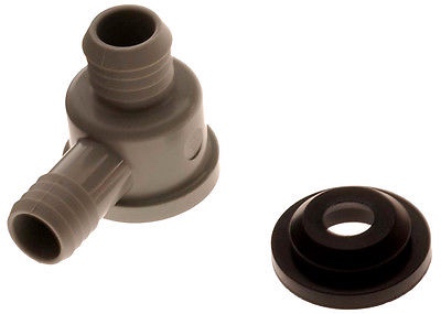

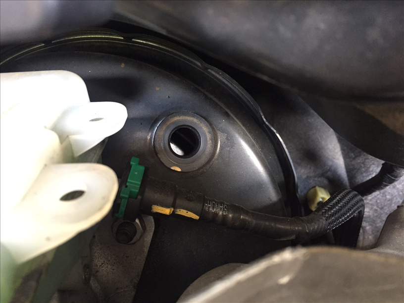

Would this be it? I found this part on my Brake Booster

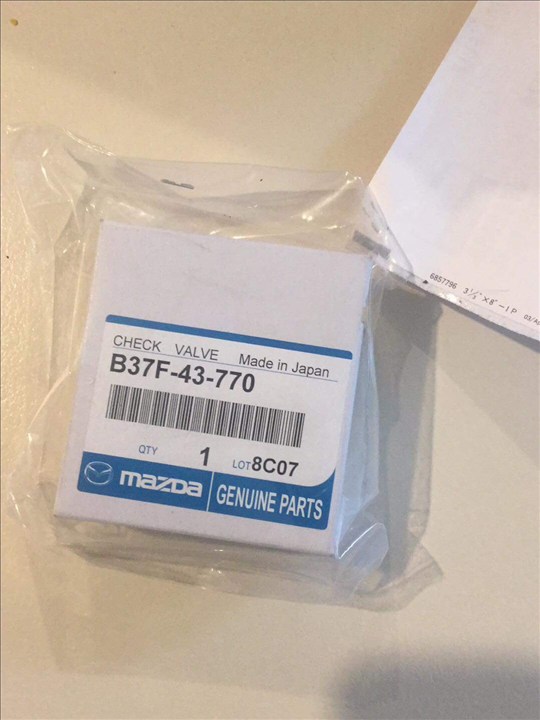

Sooooo I found the Check Valve, I can blow through and back in.
Called Mazda parts division and he said yeap that's the check valve.
So I'm ordering the part now to fit, also I put a quick photo together what it looks like

So what was the part number you ordered?
Check your brake booster, if it has a check valve like this then it will be that part, I am working on getting the number for you as I didn't get it in a pretty mazda wrapping with model number on it, I just ask for the part, it's ex japan and just gets shipped to me, I will get back to you on this as I have already ordered another one for a user that's having the same issue

Sorry about the delay, this is the part I got from Mazda and is the part that goes into the brake booster
