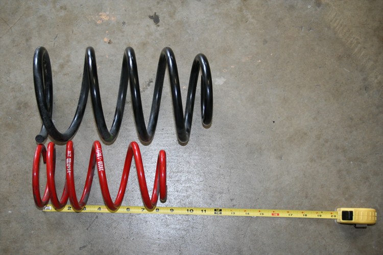

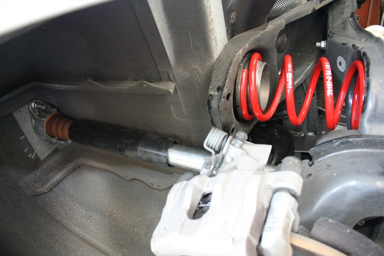

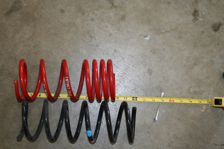

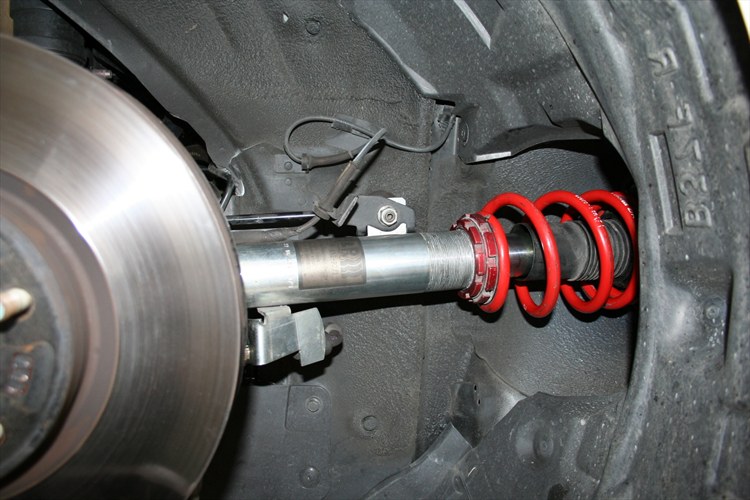

Here are a few photos. Sorry for the wierd angles. Couple of design flaws:
1. The brake line bracket is too small and needs to be widened to accommodate the MS3 brake line. Can be done with simple tools.
2. The rear adjustment perch is inverted and a pain to adjust. You will most likely have to disassemble the rears to access.
3. Front endlink bracket sits too high and is comparable to stock. It needs to sit about .5-1" lower. As a result I would recommend longer endlinks.
Few things I liked:
1. Front strut is inverted and allows for a bit more suspension travel. You can see in the photo there's about 3" of travel at full droop before the internal bump stop is engaged.
2. Rear shocks are .75" lower than stock and allow for increased suspension travel.
Side by side:
Front springs:
Rear springs:
Rears installed:
Fronts installed:
