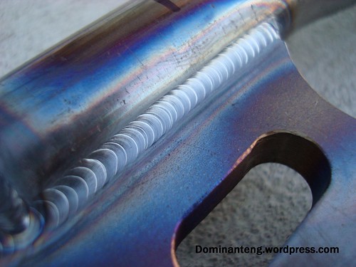

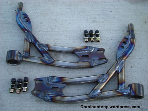

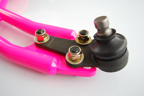

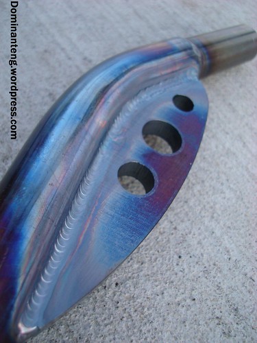

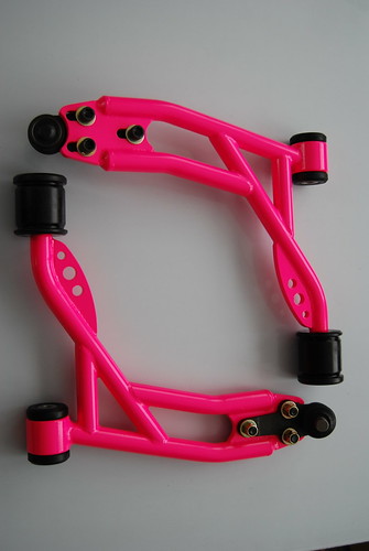

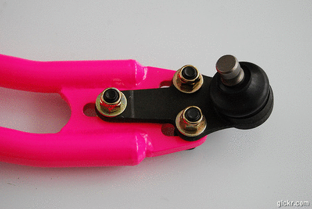

...and here are some pictures of his Focus front LCAs:
So, for those of you looking for a way to get some more negative camber, these might be the ticket.

that welded polished SS looks hot

His welds look indestructible. Diggin' the stretched side walls too. Focus is too low for any positive handling attributes, but if this guy can make ms3 parts, he's gonna have a cult following.

I'd be in for twisted mash of pink metal that gives me negative camber.

Those welds looks NICE! I am totally in. I dont have a spare lca but is there anything else i can to do help?

How can you get more negative camber from changing the lower control arm without extending the arm further out? If you have aggressive wheels/tires before, the arm will stick them further out the car.
Look at the 2nd picture in the OP.

That is moving the arm outwards.... If its at the original location, there won't be increase in camber
The arm doesn't move. Only the ball joint.
The ball joint is a part of the arm, it will move the wheel out and restrict the size of tires/wheels you can fit within the fender.
No it won't. +camber maybe, but not -camber.

Yes it will, you gain negative camber by pushing the bottom of the wheel out and keeping the top at the same spot.
With a camber plate, you gain negative camber by pulling the top of the wheel in. This creates a tucking effect, so your tires will tuck inside the fender.
With the control arm, you don't get the effect of tucking the tires inside the fender because it didn't physically change the location at the top of the wheel.
Blue line is how a camber plate works, red line is how the control arm will work for gaining negative camber

This is the lower control arm, so as you move the lower ball joint out and the strut assembly does not move its spot, the bottom of the wheel is moved out... creating more positive camber.
The ball joint connects to the hub, and the hub connects to the strut. It's negative camber.
Ahh yes you are right I was thinking positive was when the tires lean in at the top, my bad.
