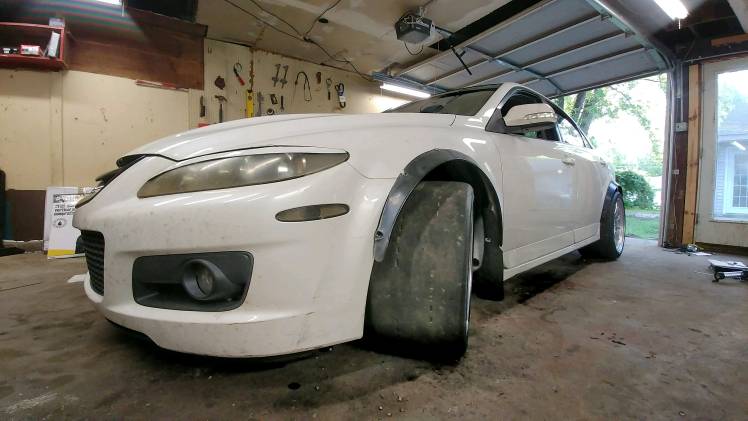

I set up the alignment based on what we were running last year. -2.5°/-3.0° camber front/rear, 0° toe all around. I didn't have the pyrometer out, but I suspect the rear could use a touch more. Tire pressures started at 38 psi all around and was really loose. We went down as far as 35psi in the rear, but grip seemed to fall off again below 35.5 - this will change as we change rear camber.
The rear bar might need backed off a bit, but I want to add a touch of negative camber in the rear first. I didn't have my pyrometer, but the outsides of the contact patch felt a little cooler than the insides on the rear. Front felt pretty even.
The car is a monster. It's making good power and is just incredibly responsive with the flow modifications and lack of intercooler. It made good power without the water injection, actually - I was able to get away with a lot more boost and timing than I thought I would. My tuning didn't go much beyond it calming down the first bit of knock I was seeing - I'm running enough timing at this point that I need on a dyno to really quantify changes. We went through a LOT of water - 10 runs, totaling to ~8 minutes of driving went through 3 liters of water.

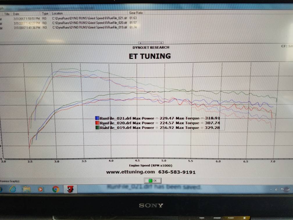

I'm curious about how much you anticipate paying for dyno time when dialing in ignition timing, (I have no experience or expectations for how long that might take), and whether you think the WI will effect ignition timing for MBT.
If i get on the rollers with fuel and boost already dialed in, it takes 1-2 hours to dial in timing.
Changing jets a couple times plus finding new mbt, maybe 4 hours total.

My preference for dynos are eddy current models of any brand. Inertia drum dynos tend not to simulate road load well enough. Eddy current models can incrementally add load to the point where they will stall out 1k+ hp cars and are typically dead consistent between runs.
I do full throttle, full rpm range sweeps and walk up timing iteratively over the rev range until I see little to no gain in power in a region, then back off 1-2°. I don't use the rpm hold function because we can't 'live flash' the ecu to watch power change in real time. I may spend a few extra minutes and do this at two different boost levels - 1 at wastegate pressure (~10psi) and another at full tilt (20+ psi)m then interpolate between the different load regions. Typically, though, there's not much difference in where MBT lies between high and low boost on a given engine.

Going to try this again tomorrow. Last weekend I pulled the car off the trailer the night before Autocross and found the clutch hydraulic line squirting fluid everywhere. It's been on for 4 years (CS braided steel), so I replaced it with a technical fit steel braided line.
I reworked the vacuum lines a bit, so I'm interested to see if braking is better. I have the next steps in mind if it doesn't work out.
Had the car on the dyno last Friday. Water injection kills power off and I couldn't make it up with tuning. E85 is an incredible fuel. Since it has such a high octane for us, the water injection doesn't pay off. I'll be pulling it soon. Graph, below. Highest line is without water, lowest line is with as much water as possible before it caused blowout, and the middle line is with the 2 smallest nozzles I had.
Sent from my SM-G935V using Tapatalk

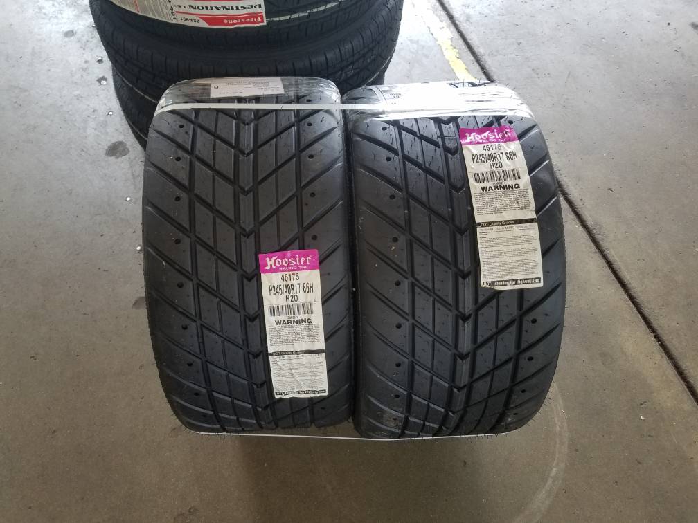

Good weekend. Saturday was pouring rain most of the morning, so we bailed. Sunday turned out to be a pretty nice day.
I ended up with a trifecta - 1st in class, 1st on overall raw time, and 1st on index. My 1st time ever for that.
I was pretty happy with the car - I put in Hawk HP+ brake pads up front and they are on the opposite end of the spectrum. Maybe too touchy, but I want to run them another day or two before I decide on something else. Great braking power at low pedal pressure, so it doesn't seem to be a vacuum or brake booster issue. I got a little more used to them a couple runs in, but still locked up the front tires very briefly once or twice.
Johanna had a rough day mashing cones. She ended up 9th on overall raw time with the cone, and would have been 6th if it was clean.
For future rainy days, I picked up some Hoosier H2O rain tires. These will go on my green XXR's. 245/40/17, but they look gigantic.
