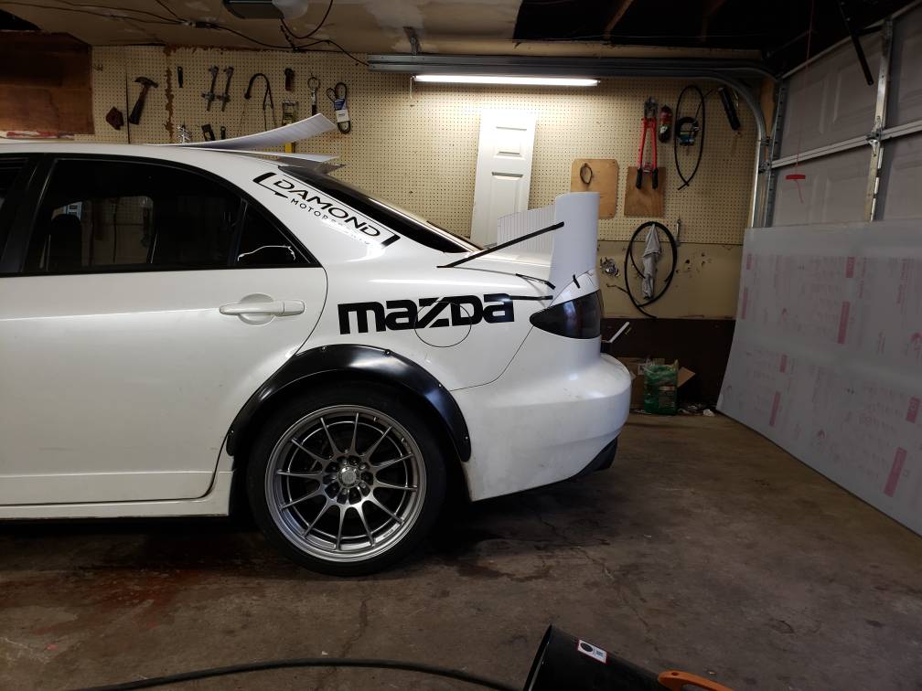

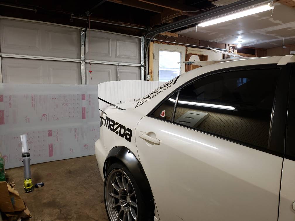

Back at it tonight after a weekend at the dragon. It was really nice to get some drive time in with the new setup. It's a totally different feel than last year, it's like the world got smoother. I'm reserving judgment until I get the car to an autocross on the hoosiers.
Anyway, spoiler things. I started over after putting a nasty fold in my first piece of foam board. Instead of praying that i didn't do it again, i made vertical folds every 1" on this piece to make it a little easier to contour around the trunk lid profile. It's still very stiff with just some duct tape holding it at the bottom.
This will be my vertical spoiler mock up piece. It's not as wide as the car, so I picked up a 4x8' piece of foam board to extend it outboard as far as possible without going beyond the top view profile of the body. I also picked up a 4x8' sheet of lexan for when I'm ready to transfer foam cutouts to real lexan that I will test with.
Spoiler supports are on their way. I contemplated making my own, but it doesn't make sense cost wise considering how long they'll take me to make.
Edit: These are going to get cut down to 10", I'm getting the trunk profile in these pics before cutting to final height.

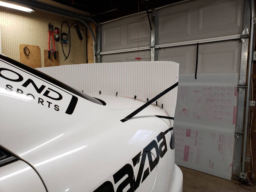

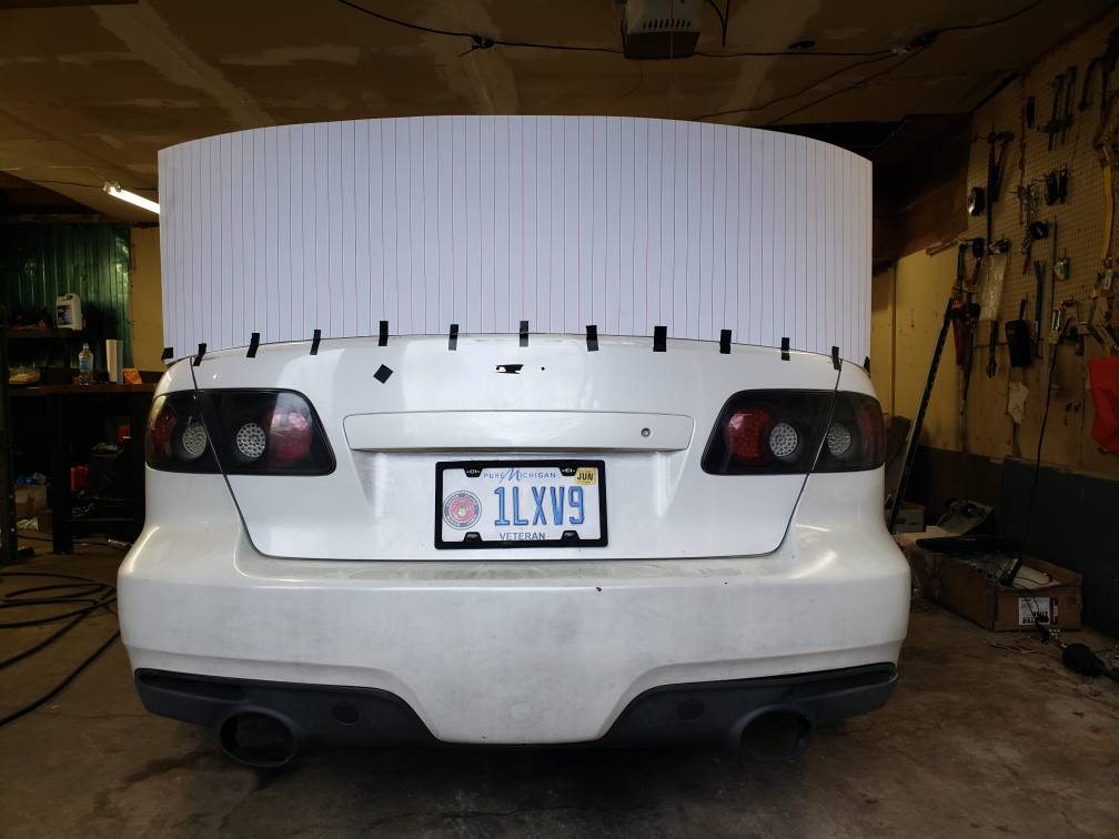

This is very close to actual height and max width. I'll trim it down for testing if width affects the performance. It's ready to transfer to lexan.
I started on the laid back version after this, but it's definitely not as easy to mock up. I'll work on it more this week and next.

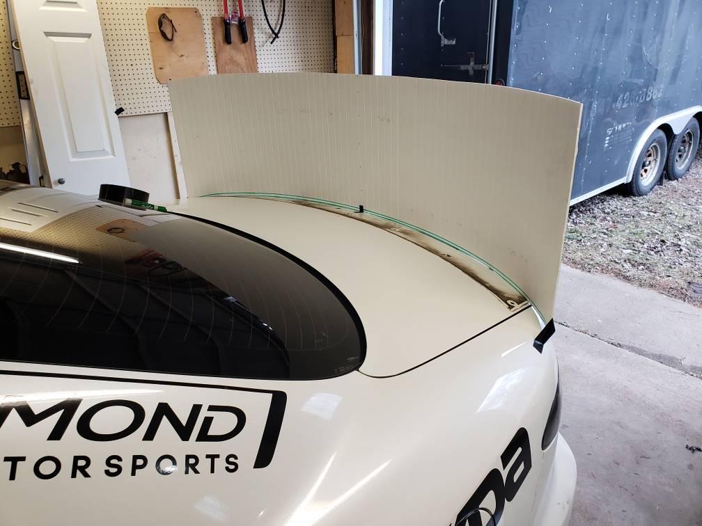

I worked more on the angled spoiler last night. Starting with a single piece and trying to trim it to conform was really difficult, so I changed my strategy for this one. I cut a bunch of short, narrow pieces of foam board and taped them in place at the desired angle.
I then pulled that off and transferred it to a larger single piece. That got me about 90% to where I needed it to be. I stuck the new turnbuckles on with double stick tape to mock them up. This piece still needs trimmed down to the 10", as it sits in this pic it is about 15" tall.
I'll resume this project next week.

But first, I wanted to check out some edge seals I purchased. This is the one I decided to go with. It's an aluminum reinforced EPDE push on rubber seal.
That helps me out so I don't have to get the lexan perfectly contoured to the trunk lid. I trimmed the lexan probably 5 times before I was really happy with it. This edge seal grabs on hard, which is pretty obvious when you struggle to push it onto the edge. But, it's on -
I guess I forgot to take pictures mid drilling and installing riv nuts. I used M8 hardware for the angled brackets and M6 hardware for the turnbuckles. First stab at it:
I was really slacking on the pictures. I trimmed the lexan to be 9.75" off the deck lid. The rules state it can't overhang original bodywork when viewed from above - so I took a plumb bob and marked and trimmed the left and right edges to be barely within those confines.
