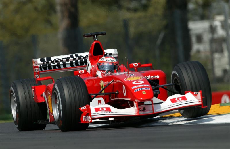

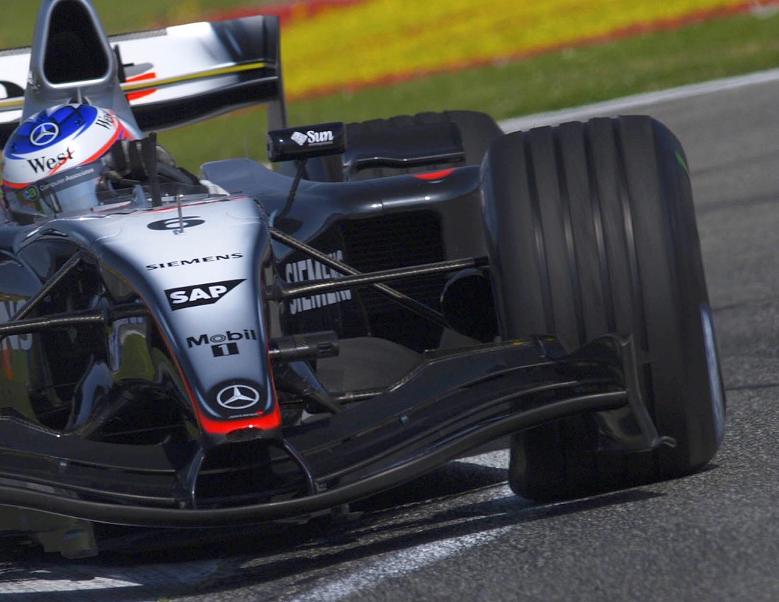

Autocrossed on asphalt yesterday. It's a totally different animal than the concrete I'm used to running on. Grip wasn't available like usual. I ran two sessions, one in the morning that consisted of 5 runs, and an afternoon session with 7 runs. I was mostly working tire pressures and taking tire temps and trying to reign in the oversteer that I started out with.
I ended up with pressures of 32.5F/33R, which is the closest I've ever had them. That gave me some manageable mid corner oversteer, but the car still has some steady state understeer. Turn in is a little numb, but I attribute that mostly to the Rivals. They weren't crisp the first time around, but the wider/slightly stretched tire this time around is definitely better.
Tire temps were kind of interesting. There was a hard, straight braking zone coming into the finish, so I think inner tire temp readings were a little hotter than they would have been otherwise, so I'm taking that into consideration. Mostly - I need more negative camber most everywhere. The inside region of the tread on the front tires was just slightly hotter than the outside by ~5° on most runs. The rear tires had almost completely even heat across the tread. With the assumption that the inner tread was slightly hotter due to the last braking zone, I want to try more negative camber to see if we can pick up more cornering power.
On the max camber front, we've been discussing it on our local autocross forum. There are folks running upwards of -3° without any [claimed] reduction in braking power. I have at least that much to play with, and I might be able to add in some caster by rotating the ball joints a bit. I'll work on that next weekend if I can. We have a test and tune, and should have tons of runs.
This was my fastest run from the day. Check out the tire rollover, it's amazing how much it has. That's the pressure they seemed to like on that surface, and they weren't actually rolling over onto the sidewalls. They were pretty happy and pretty easy to drive..
Originally Posted by KevinK2 View Post
Even with the stiff spring set-up, it appears to have more body roll than desireable.
The wear on the front tires really get across the outer edges, lots of slip angle ... great camera work! I know you are going for more camber, but did you try more pressure F & R, like 36+ psi?
Your tires are definitely moving, but actually less than I expected. I'm used to seeing videos of big floppy race tires or oversized street tires on an undersprung car.
I can relate to the low pressures v tire roll. I was running 32 psi on 255's on 10's and saw roll right at the outer marker for the front tires. However, I'm beginning to wonder if that the tires on the front setup are under cambered and are still overtaxing the outside edge, but due to a lack of body roll essentially scrubs the tire flat vs rolling the tread and scrubbing. I'm not sure how adding pressure would help this.
This is a something that could be looked into with a pyrometer. Didn't happen to record the raw data did you?

I started around 34/36, they increased to ~36/37 and grip was down and the car was very loose. I dropped it as low as 32/32, but that seemed to be too low as it wasn't as fast or responsive.
I was ~1.7s slower than the fastest door car, so not bad imo.
Sure did, but of course my notebook is with my autocross box, in Johanna's garage. I'll ask her to grab it. I tried to record as much as I could so I have something to look back on.
Are you coming down for the test and tune this weekend? I'll have my pyrometer if you'd like to use it. Might even have an accelerometer by then!

.... I can relate to the low pressures v tire roll. I was running 32 psi on 255's on 10's and saw roll right at the outer marker for the front tires. However, I'm beginning to wonder if that the tires on the front setup are under cambered and are still overtaxing the outside edge, but due to a lack of body roll essentially scrubs the tire flat vs rolling the tread and scrubbing. I'm not sure how adding pressure would help this.
EDITED:You see a lack of body roll for your car. From Phates video of his car, I see about 5-6 " at the wheel, in terms of max gap and min gap, and also know larger sway bars are the way to reduce roll, but with the oem front bar, and an effectively 2mm larger rear bar where the MR is .56, Phate's not getting much anti-roll from the set-up, imho.
In the tire pressure, I was wrong to suggest raising both front and rear to ~ 36+ psi, and Phates subsequent notes show that made things worse. You are right in that higher pressure would not help the front edge wear on the stetched fit tires.
Originally Posted by Phate
... I started around 34/36, then increased to ~36/37 and grip was down and the car was very loose....
With this info, I read +2 psi up front did increase front grip, and/or +1 psi at the rear decreased rear grip. So 1st logical step would be to change one variable. I'd leave the front at 34, and reduce the rear by ~2 psi. That is 34/34, and we now know Phate was best with 32.5/33. Of course this is after knowing what worked from Phate, but it's a logical path vs my quick suggestion to raise pressures to 36+.
One thing to remember is Phate's control arm bushings are close in stiffness to new oem's, so some neg camber loss is due to bushing flex in the corners, which supports the general agreement to increase neg camber.
