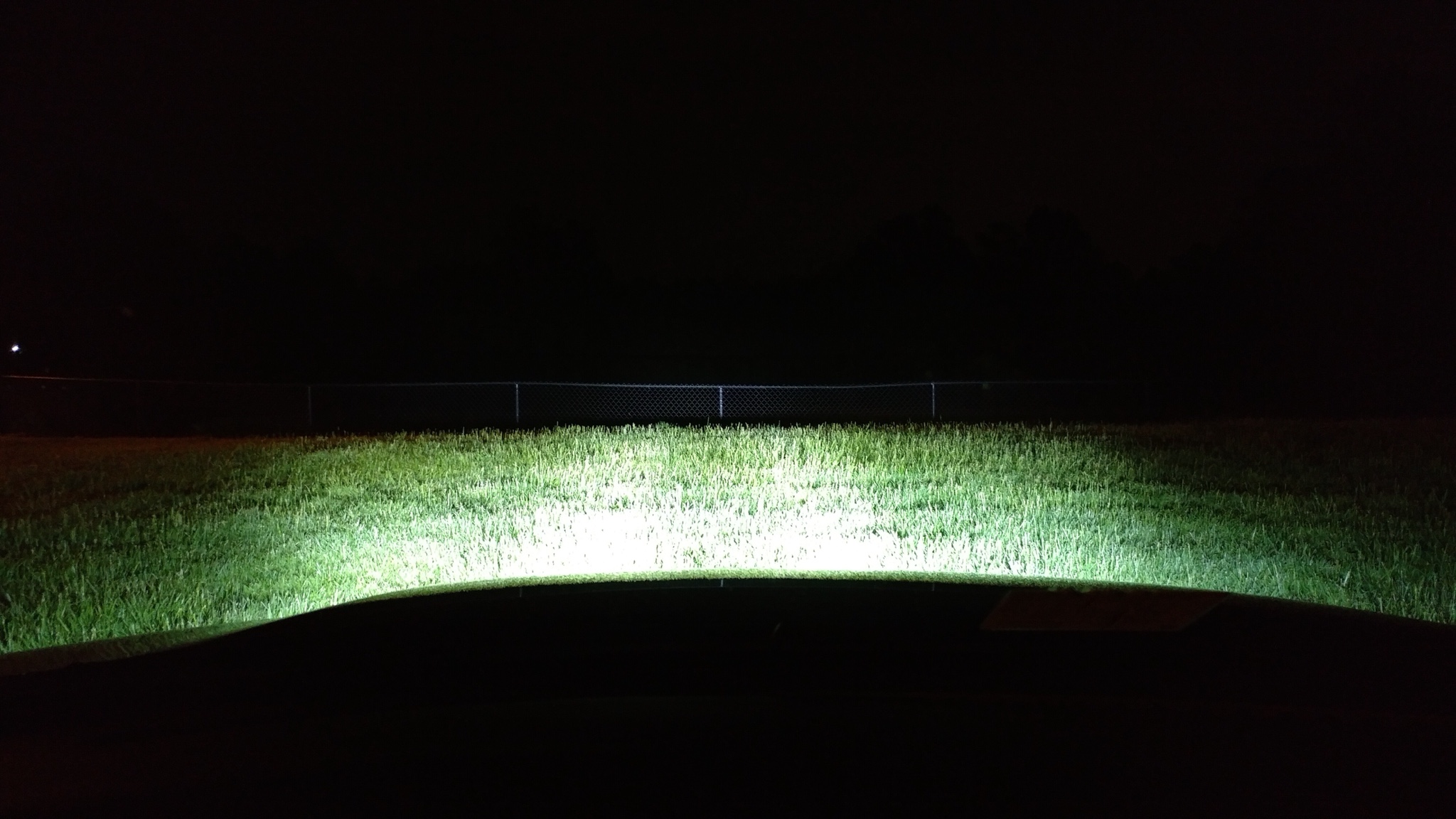

OPT7 LED Headlights are amazing. They are bright, but not distracting to other drivers, the 7k Lm brightness is perfect (white, not blue), and they have a 2 year warranty. One of my fogs crapped out on me probably due to my constant removal of my front bumper, and they were totally cool about it and sent me a new set free of charge. Great company, great LED lights. These are the ones I got for my Gen2 MS3:
Low Beams: https://www.amazon.com/gp/product/B00VNBDWPK
High Beams: https://www.amazon.com/gp/product/B01ACOCMLS
Fog Lights: https://www.amazon.com/gp/product/B00WNQGYHC

Wonder how much brighter my H1 high beams would be with those OPT7. An H1 halogen bulb is around 1550 lumens. These are rated at 3500 lumens.
@Solarsurge; how much brighter are your high beams now? Very noticeable difference?
Substantially brighter. This was in a very poorly lit area, across a small field, and you can see the fence clearly on the other side.
