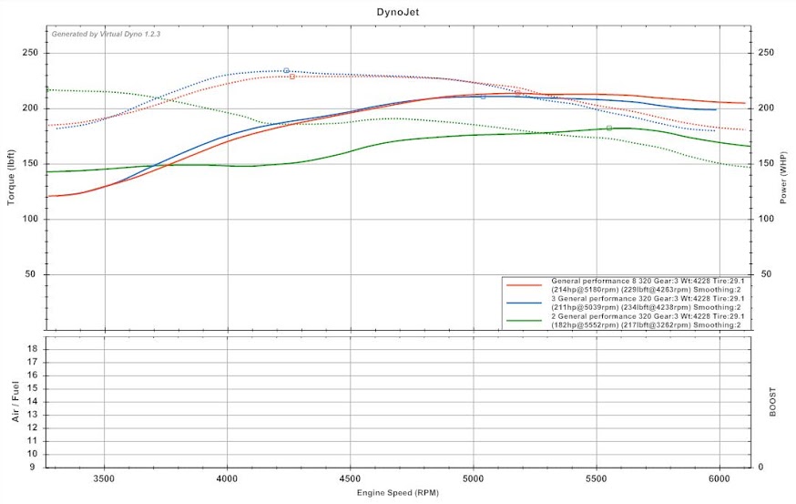

I don't know how familiar you guys are with Virtual Dyno, but it's been proven to be fairly accurate over the years. It's been a while since I messed with tuning our CX7 at all but here's a graph that shows the gains I saw just from tuning. The only mod (if you would even call it that) is a K&N drop in filter.
The solid lines are HP and the dotted lines are TQ. I picked up about 32 whp and 17 ft/lbs of wtq at peak, but the real story is how much smoother the power curve is and the gains throughout the entier rev range. You can see some spots where there's close to 50 ft/lbs between the before and after torque curves.

Hello. Updated firmware. On this we will stop before installing FMIC or TMIC + WMI

Very good results...keep up the good work
