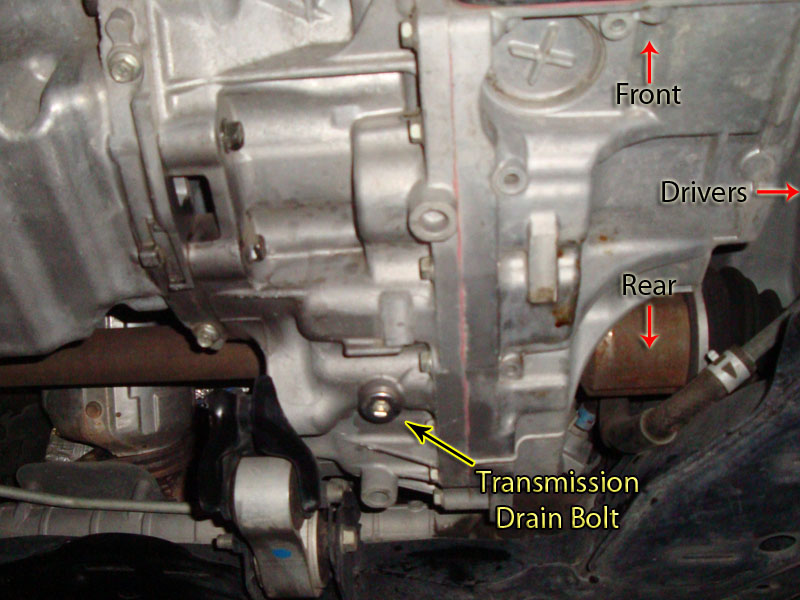

The hex on the drain plug is 10 mm, like the bolts that hold the engine cover on.

 Old 05-24-2011, 06:24 PM   #20

I'll get a pic sometime this weekend, been meaning to for a while. But yeah, it's the 10mm allen right there on the bottom of the engine. It's toward the driver side from the oil drain and there's nothing else really around it. It is flat too, and kinda shiny, relative to the other metals under there. If you take one of the bolts from the engine cover and can fit it in the hex, that's the one.

Thanks. Looking forward to the pics. While you're under there could you point out the fill and drain plugs for the front diff and or transfer case? I'd appreciate it alot as would others I suspect.

Here's a pic of the drain bolt for reference:

Talking Guys, I figured it out, finally, Procedure below.
I figured this out by watching a YouTube video for a guy changing his 2011 Mazda 6 transmission filter and fluid. Apparently, the transmission on the 2011 Mazda 6 and the CX-7 are not all that different, at least visually.
I started out by taking off the hex plug and draining the fluid.
Then I got to work on the 18 bolts that hold the pan onto the bottom of the transmission.
All came off easily, the 3-4 behind the frame required me to take off a plastic shield that is in the wheel well, between the wheel and the transmission. That used 3 nylon Philip screws.
Once all of the bolts were off, I had the hard task of prying off the pan with a paint scraper and undo the pink, liquid nails-like gasket adhesive caulk that Mazda uses to glue on the pan.
It broke off all at once,- without warning, so I got about 1/2 quart of fluid splashed onto my face when it suddenly broke free! Luckily is was not that hot by that time, but it was a REAL frigging mess! After a shower , I cleaned out the inside of the pan with 4 paper towels.
It was dirty after 47K miles, and some clutch dust and dirt was at the bottom, so I made that clean. I was able to pull out the plastic filter, put in the new quite easily, the reverse the installation, using the gasket that came with the kit. Once you pull off the filter, another 4-5 ounces will also come out behind the filter. FYI
The new gasket has 4 tabs, so that you can align it as you place the pan back on. Put all 18 bolts back on with your 10mm socket. I then put 4 quarts of new M5 in there, put the plastic wheel well shield back on, and it is running well.
GeorgioP is offline   Reply With Quote
You went to a lot more trouble than I plan on but probably got most of the fluid short of a full-on dealer flush. Keeping a close eye on the fluid color/condition, I'll compensate for my laziness with a more frequent 20k-mile drain/refill interval. The idea of doing your procedure every 30k just isn't appealing to me, I'm afraid, but a filter change at the next interval (100,000 miles) will be a good idea. In the meanwhile I'll stay on this side of that tranny pan!
