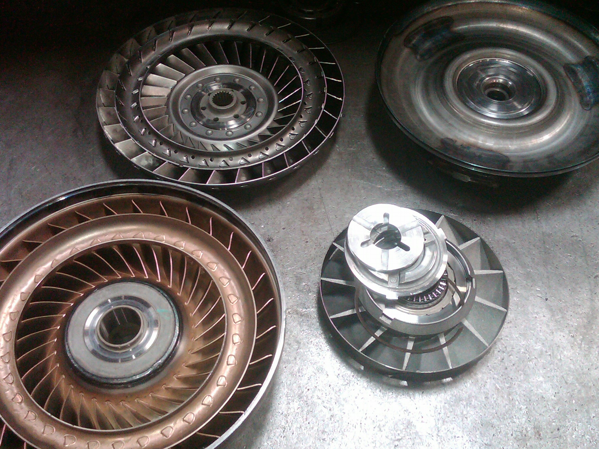

The torque converter has been sliced open.
I am 99% sure the fins on the pump (1st pic) are not supposed to be bent like that. They show no wear marks however so I would say they were bent with oil pressure alone. It does not appear the pump blades had contact wit the stator (2nd pic) as that funny profile doesn't really show any rubbing marks. The profile toward the outer edge of the blades seems to be cast on purpose. I can't see how the two could touch since they are separated by a thrust bearing although the hub of the pump shows some discoloration. Could be from welding though. Meh.
How the fuck those fins get bent from a lack of oil is still beyond my understanding of how torque converters work but I am getting there.
Fins on the turbine look ok.

IDK man, those fins are all bent uniformly and as you say, how could oil pressure bend them, so I think they are supposed to be that way.
are they bent that way as to let oil pass (not get pumped) thus creating the stall point?
so say a 5K RPM stall converter may have 1/2 as many fins so as to not pump fluid to the tranny planetary gear clutches and lock them until it approaches 5Kish?
OEMs bend the fins to achieve a smoother transition?
BTW, i have zero knowledge in this area just attempting to think logically.

At 3:55 "the fins are bent to exact specifications to set the stall range"
so there you have it. they are supposed to be bent. no idea why you POS is...well acting like a POS.

Of course the fins are bent to a specified angle. Usually called the stagger angle. The fins normaly have straight leading edges however. Not curved ones like you see in pic 1. The edges should look like in pic 3.
Like I said, not 100% sure but 99% sure those fins aren't supposed to look that way.
More like this:

I see what you're saying but at the same time I can't see them getting bent.
I guess it's time to Google "burnd up TQ converter" , to see what to expect.
