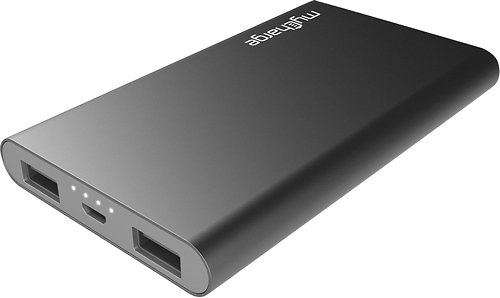

 Old 02-03-2018, 10:38 AM   #23
gs1150's Avatar
Join Date: Feb 2018
Posts: 3   (View Stats)
gs1150 is an unknown quantity at this point
Originally Posted by Constantin View Post
I'v been told that if you use stereo's ground for the ground on your phone charger the "noise" should be gone. No need for isolator. I'll try it one if this days
I got around this by charging my phone with an external battery/charger that I keep in the glove box. Its very slim and small , its like 6500 ma and keeps the phone charged for as much time as I have ever been in the car. When I leave, I plug in the external battery pack to re charge
gs1150 is offline   Reply With Quote
