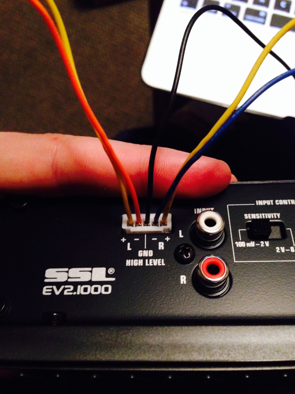

@surfwagon;
Here is the high level input. did you hook up the ground wire? and which wires will I splice into the white with blue stripe and gray wires?
thanks!

Originally Posted by pbeeezy View Post
@surfwagon; Here is the high level input. did you hook up the ground wire? and which wires will I splice into the white with blue stripe and gray wires? thanks!
Surfwagon is long gone. He did the kid mod and swapped for a G37.
Ferdball is offline   Reply With Quote

so has anyone else wired the high level input and can you help me out? Maybe I'll just do it with a LOC (I bought one anyway...)

I'll make it simple for you and just run down to my car and take a few pics for you.
xTRELLx is offline   Reply With Quote

I just took my car apart for you man lol. Rotate the pics and zoom in then you'll be good.
jax ms3gt likes this.
The Following 2 Users Say Thank You to xTRELLx For This Useful Post:
jax ms3gt (01-06-2014), pbeeezy (01-06-2014)

Thanks for the pics man, glad to hear it works with bose
Sent from my AT100 using Tapatalk
PERM TUNED
