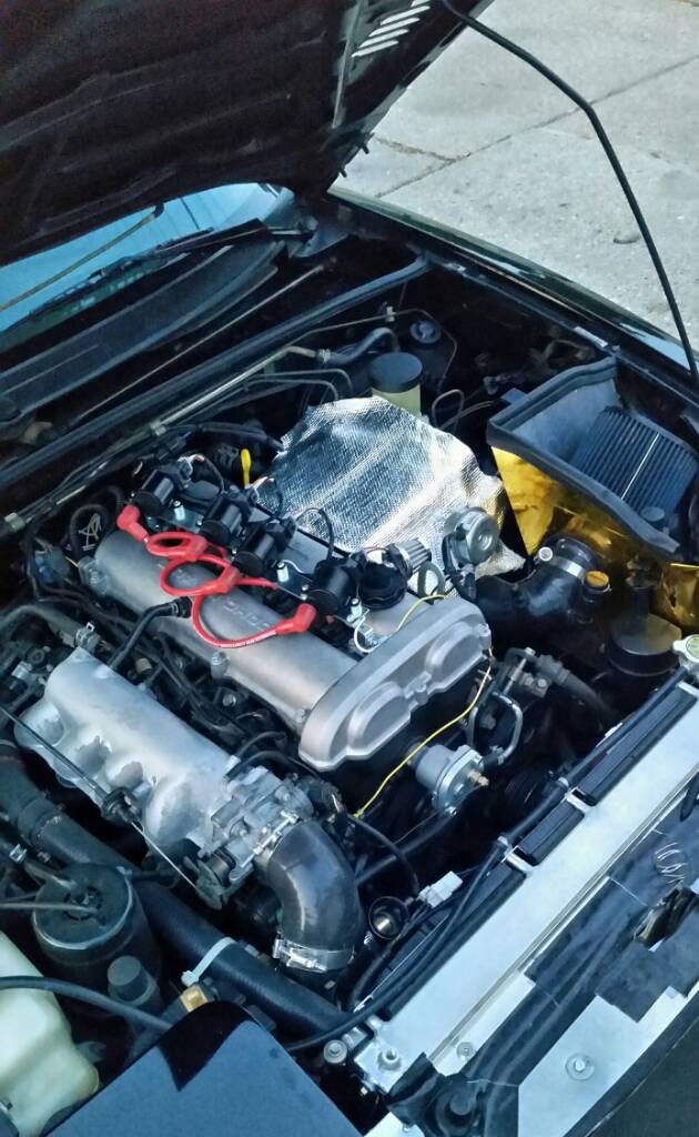

Well my stock coilpack is dying, screw spending $300 on a new one, time for LS2 coils. Wish me luck lol.

It was a good day. She fired up first try with these beastly coils.

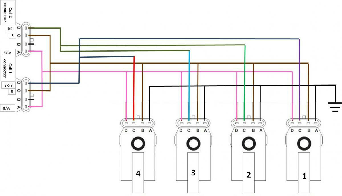

Do you have a part number list for what was needed for the LS coils and is it on stock ECU or MS?
I run hydra, same process for MS3 though. All you need are the coils and some wire, here's how I set them up. Wasted spark just like factory, only adjustment are the dwell times. And your factory plug wires have to be crimped down to fit the LS studs.
