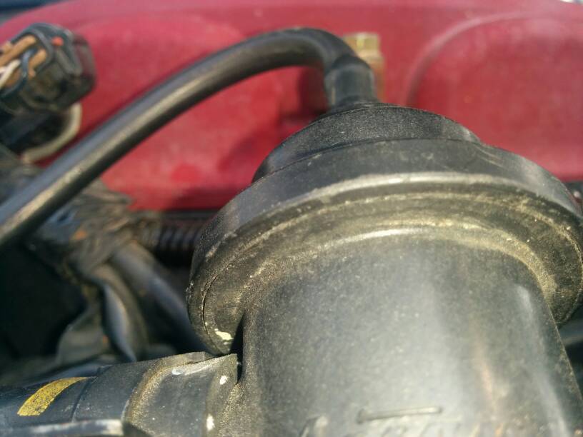

got that pipe replaced! no more shitty tape. and I know, my engine bay needs to be cleaned up a bit
I'm still leaking boost but not from there and the car is running a lot better. hopefully this saturday a friend and I will locate the source of the leak. Also going to re-wire my a/f gauge since that's not reading properly.

Are you still running the OEM throttle body inlet pipe from the IC? The sensor on the backside of that rubber piping likes to rip, causing a boost leak. BEGi makes a legit replacement TBI.
Yeah I am. I was looking at a Flyin Miata replacement. Should be about $250 with a BPV

If the stock BPV is working, no reason to run an aftermarket. Save your coin, get the BEGi TBI. I like FM, but they charge way too much for shit. Completely unnecessary.

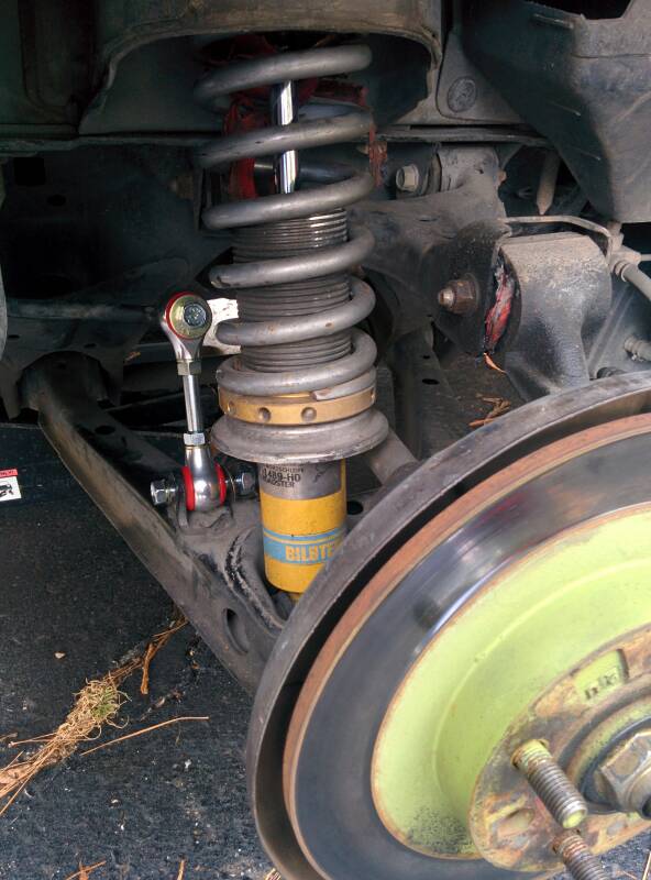

yay more car pics. Tried to install my rear end links that my friend gave me and I guess something snapped inside. Gotta wait until I can get a saw and cut the bolts off now or get a rear sway bar. Probably gonna do the latter since I need one anyways. Had some problems with boost earlier today. Set at 11 and I hit 13 getting on the bypass in 4th. WOT in 4th again and I hit 11lbs and slowly declining. Went down to 10 then I let off. Think this is the culprit. so I ordered a forge bypass valve. Hopefully that helps.
