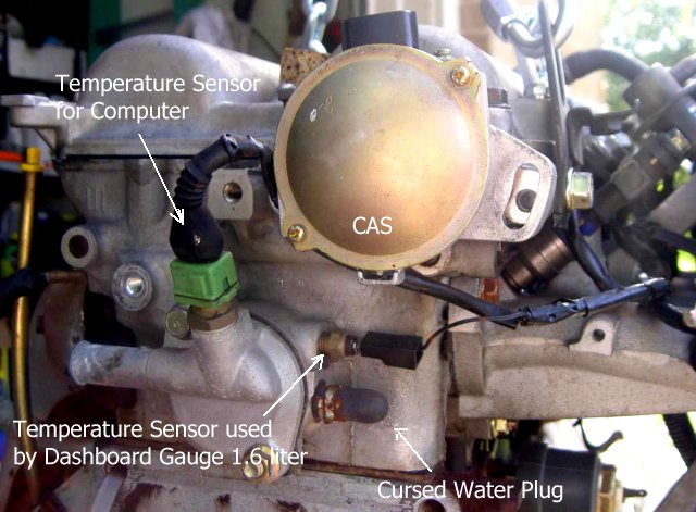

I've got a buddy of mine who's going to help me do a compression check on Saturday...I want to make sure I disconnect the right connections to avoid screwing things up/frying the coil pack. As I understand it, I disconnect the two items I'm pointing at in the picture (CAS & coil pack), pull the plugs (duh) and crank with the accelerator matted to shut off the fuel. Does this sound correct? Thanks from one homo to another.

What's the recommended method for permanently plugging the "cursed water plug"; tap it and screw in a permanent fitting?
