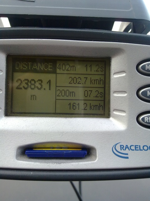

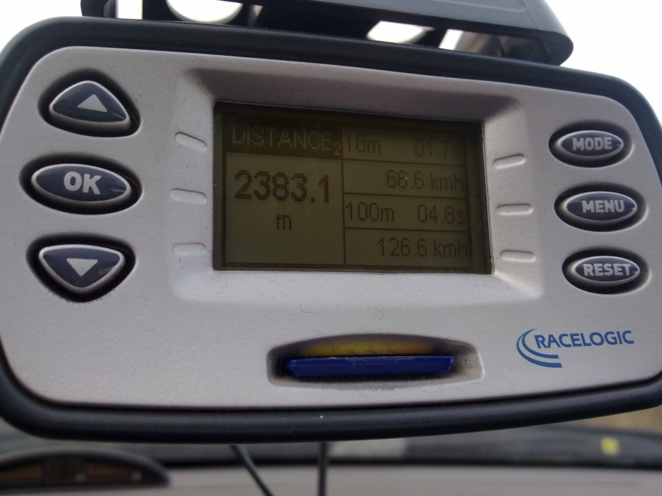

Hi to everyone last weekend we have a drag race to my country at Tympaki Airport, Kriti, Greece...
So i manage to make 1.800 60FT , 7.363@100.90 660FT , 11.114@131.04 my car is with the same turbo(gtx3071) from my last race (wich i made 11.41@127.5) but i have raised boost to 37psi , i change slicks to 27/9/15 , i also use rear skinies nexen 165/85/15 on vision wheels.The car was with full interior due to my country drag rules.I`m waiting for your comments....

Was that a head wind? Nice job man! Closer and closer to the 10's!!

Seems like u are testing the track for Unlim500. all 402m are in glue. Next year I'll run on good dragstrip in Russia for result.

yea we make a drag race to prepare the strip for the ulim500 which is this weekend. Glue for know is for about 660FT(200m) ....but until this Friday it will be ready with 402m covered with glue(but only for the unlim500)...

I think 200m is the best variant for u. u don't need glue on whole track.
ur time is very fast. may be u can try <11s with lightweight in out of rules. Just run for record, cause I think u have no reserve in power on gtx3071?! What is ur whp?
Also in Eupatoria (Crimea) on RDRC (Russian dragchamp) last autumn fwd had stable 1.5-1.6s on 60ft. Gluestrip was prepared by ur Greece guys!

Congrats man. Very nice launch!

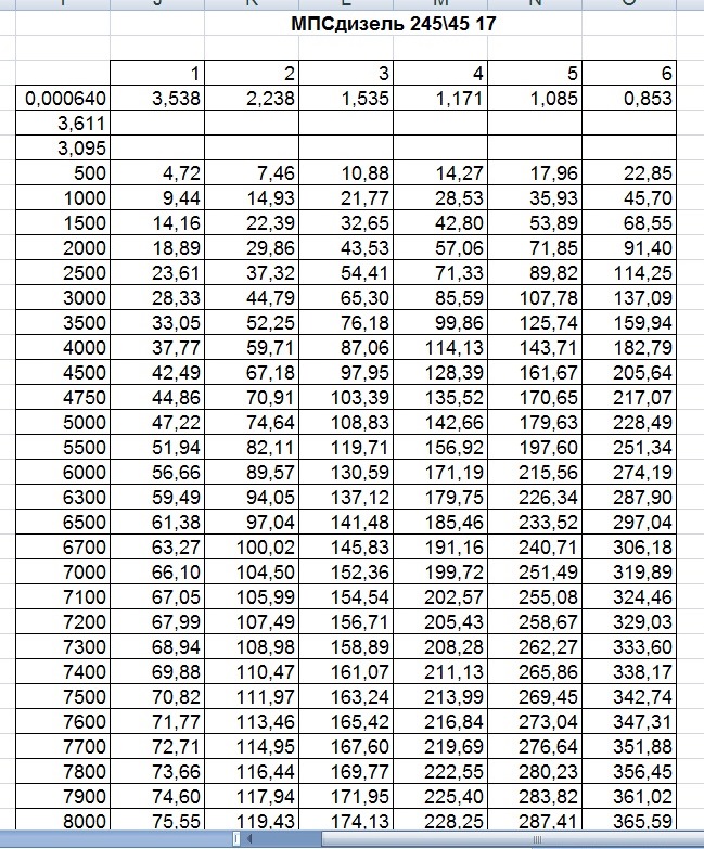

have u tried it?
can u show ur km to rmp?

I will try to explain it to you but my english isn`t so good
i have the diesel gearing for about 2 years and have not try it because in my opinion with the longer gearing it wheel spin even more ,when the car spining with longer gearing the wheels spining on biger speed so it is even more difficult to stop spining when it starts..
i do not have calculate km to rpm but i have a video from an 11.4 pass i made this weekend that shows tacho with revs ...I will upload it to see it ...

my English is probably worse)
longer gears are better IMHO and u have glue track + good slicks. And diesel pair gives +9% to all gears, u can shift with no falling to low rmps.
but we can compare ur and my variant.
