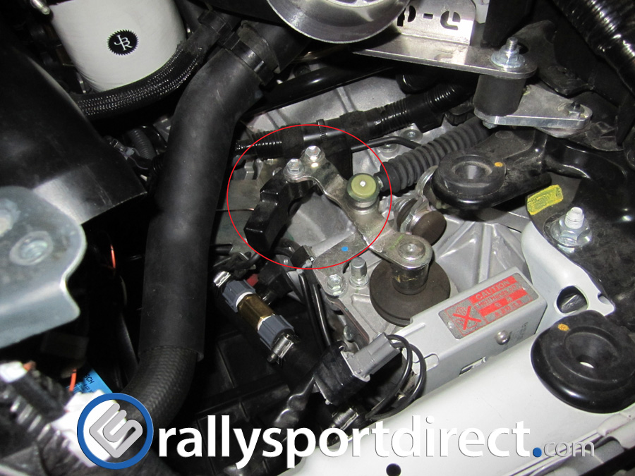

The shift weight is located above the trans at the end of the shift linkage. Removing the weight may help.
Do you have an aftermarket RMM, I didn't see that in your mods. Replacing the shitty OEM rear mount may do wonders to help this.

it's in the engine bay.

I have the same problem as @Flawless; but I have rmm, short shifter kit, and bushings. I don't understand how to adjust the shifter if all the other gears work great. Mine's not everytime, but most of the time that I am going full throttle
Maybe I need to try the unicorn juice, and that may be the magic.

I was having this problem until I took @Mike@Stratified; 's advice and enabled FFS and reduced the RPM - over-revving seemed to be the culprit. DM RMM and SSP, OEM fluid. If I miss 3rd gear now, I know it was 90% on me.

Your FFS has to be set under your shift rpms. Mine is set to 5800, I shift at 6200 and it works better than lifting to shift for me. I have all mounts, shifter plate and bushings, and Ford fluid. I think the fluid did the most.

What's the specific type of fluid I should be looking for? Is it special order only?

no its at every ford dealership. Its called motorcraft xt-m5-qs

There's nothing wrong with your car. You're just shifting too fast and missing third. You need a RMM to hold the motor in place so 3rd gear stays where its supposed to be. Your car is hooking 2nd gear (stage 1, street tires, track) meaning that motor is twisting way out of place and when you go to ram it into 3rd your just missing the gate completely. Trans fluid will help the tranny shift quicker but it won't help you find 3rd. You need a RMM to do that...or wait for the motor to settle back into place then shift.
These tranny's don't like to be shifted fast in any set-up so your gonna have to slow it down regardless. I've made over 400 passes and have missed 3rd plenty of times and they were all my fault, not the cars.

i beg to differ, i can shift as fast as i want and hit the gears. rear motor mount, solid bushings, motorcraft, no shift weight, weighted shift knob, and adjusted shifter to optimal smoothness

Well I picked up 3qts today, rmm should be here friday and will get installed and I also plan to drop my FFS down to 5200. I don't plan on taking it back to the strip anytime soon (it's a bit of a drive, and last time was such a failure ) Any tips for what I should do next time when I'm actually driving? Should I fiddle with the shift weight?

Preload the shifter before the shift so you don't have to coordinate hand and foot. The clutch becomes a switch for the next gear. It'll be in the next gear before you can possibly get the clutch out. I always open palm the 2nd to 3rd and 4th to 5th.

practice on the street, as i said earlier i personally like the shift weight off. If you feel like the gears arent lined up correctly with the shifter you can adjust the shifter itself

So did the fluid change, still having the issues, but it's only when I'm driving it really, really hard (keep my foot all the way to the floor right up until the shift, instead of sort of "feathering" it out). No rmm yet, but should I try to tinker with the shift linkage?

get the rmm before you rip the plastic pads off the shift forks shifting hard with the engine rocking around. thats an expensive repair.

yes, watch this video. just get it so it feels perfect when driving normally. THEN drive it hard, if you are still missing wait to do the rmm and shifter bushings then try it out and see if you can hit all the gears.
